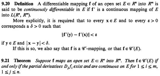

The following theorem in baby Rudin can answer the question:
