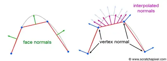

Suppose i have triangle in 3d with vertices $v1, v2, v3 \in R^3$. Each triangle vertex has associated normal vector $ n1, n2, n3 \in R^3, ||n_i|| = 1$. In computer graphics such vectors sometimes called smooth normals. By interpolating such normals it's possible to obtain approximation to real surface normal in the middle of triangle (I attached the picture for clarity).
Suppose i also have a point somewhere near my triangle $p \in R^3$. How i can find such position on triangle and interpolated normal so resulting ray points to my point $p$?

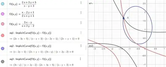

These three 2nd degree equations represent conic curves. Please note that the third equation is redundant ; in fact it will be useful to select among the solutions to the system formed by the two first equations
Therefore, your issue amounts to find the intersection(s) of 2 conic curves.
Here is an example of (2) obtained with Geogebra (the coefficients have been arbitrarily chosen...) with a single solution (the intersection point of an ellipse and two hyperbolas) ; please note that if consider only two of the 3 conic curves, we have two solutions.
