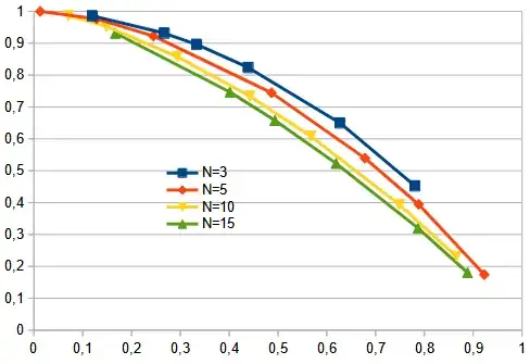

Here's at least some numerical results, from simulations. The horizontal axis is $\rho$, the vertical axis is the estimated entropy, normalized to $[0,1]$: $H'=(H-1)/(N-1) $
As you mention, the evaluation of the entropy amounts to integrate a multimensional gaussian (albeit zero mean and symmetric wrt the components) over all the quadrants. The answers to this question have some pointers. Eg this one
The most specific reference I found is this one .

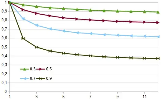

Added: from the same simulations, here are the conditional probabilities $H(\xi_i|\xi_{i-1},...,\xi_1)$ for diferent values of $\rho$. I wonder if there is non-zero limit for $N\to \infty$...
In case someone is interested, here's the Python code

  • cool, thanks. So each goes to $1/N$ at $\rho=1$. And you sample from the Gaussian with the $sin(\pi/2\rho)$ covariance and then compute the entropy directly using empirical frequencies? – puelmato Apr 13 '22 at 04:13
    Looks quadratic around $\rho=0$ for all $N$, but becomes more linear away from $\rho=0$ as $N$ is increased. It might be easier to see the large-$N$ limit if you subtract 1 and divide by $N-1$ to pin the $\rho=0,1$ values for all $N$ at $1$ and $0$ respectively. – puelmato Apr 13 '22 at 04:23
  • @puelmato Good point, done. – leonbloy Apr 13 '22 at 11:55
