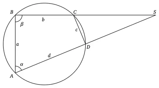

Generalization. Let $a$, $b$, $c$ and $d$ be the sides of a cyclic convex quadrilateral. Let $\angle{DAB}=\alpha$ and $\angle{ABC}=\beta$, then the following identity holds
$$\frac{\tan\frac12(\alpha-\beta)}{\tan\frac12(\alpha+\beta)}=\frac{(a-c)(b-d)}{(a+c)(b+d)}\tag{2}$$

Inscribed Generalization
The power of the point $S$ is equal to both $\overline{SA}\,\overline{SD}=\overline{SB}\,\overline{SC}$; therefore, $$ \frac{\overline{SA}}{\overline{SB}}=\frac{\overline{SC}}{\overline{SD}}\tag5 $$ and since $\angle ASB=\angle CSD$, SAS says that $$ \triangle ASB\simeq\triangle CSD\tag6 $$ Therefore, $$ \frac{\overline{SA}}{\overline{SC}}=\frac{\overline{SB}}{\overline{SD}}=\frac ac\tag7 $$ Thus, we have $$ \begin{align} b&=\overline{SB}-\overline{SC}=\overline{SB}-\overline{SA}\frac ca\tag{8a}\\[6pt] d&=\overline{SA}-\overline{SD}=\overline{SA}-\overline{SB}\frac ca\tag{8b} \end{align} $$ From $(8)$, we can solve $$ \begin{align} \overline{SA}&=a\frac{ad+bc}{a^2-c^2}\tag{9a}\\[3pt] \overline{SB}&=a\frac{ab+cd}{a^2-c^2}\tag{9b} \end{align} $$ Now we are ready to apply the usual Law of Tangents from $(4)$: $$ \begin{align} \frac{\tan\left(\frac{\alpha-\beta}2\right)}{\tan\left(\frac{\alpha+\beta}2\right)} &=\frac{\overline{SB}-\overline{SA}}{\overline{SB}+\overline{SA}}\tag{10a}\\ &=\frac{(ab+cd)-(ad+bc)}{(ab+cd)+(ad+bc)}\tag{10b}\\[6pt] &=\frac{(a-c)(b-d)}{(a+c)(b+d)}\tag{10c} \end{align} $$
