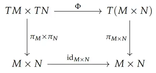

A more highbrow way of arguing for 1. would be to draw diagrams. First note that $\Phi$ acts as identity at the base level:

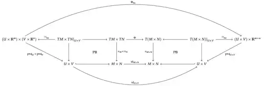

Here $\pi_K: TK\to K$ is the natural projection of the manifold $K$. In light of this, wlog one could use the products of local trivializing charts $U,V$ for $\pi_M:TM\to M$, $\pi_N:TN\to N$ respectively as local trivializing charts for $\pi_{M\times N}:T(M\times N)\to M\times N$. Then the following diagram makes the above argument more rigorous:
(As I'm writing this part somewhat in jest I'll leave it here.)
