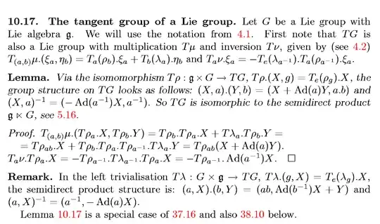

From The Tangent bundle of a lie group is isomorphic to a semidirect product. we obtain a more natural group structure on the tangent bundle, induced by the semi-direct outer product: $\mathfrak g \rtimes_{\operatorname{Ad}} G$.

I think it's easiest to see the structure geometrically using a bit of synthetic differential geometry. Here, the tangent bundle is a function space
$TG:=\operatorname{hom}(D,G)$
where $D := \{ \delta \in \mathbf{R} \mid \ \delta^2=0 \}$. The $\mathbf{R}$ here is the ring of real numbers but augmented with nilpotent infinitesimals. So tangent vectors to $X \in T_g G$ are literally (infinitesimal) curves $X: D \to G$ with $X(0)=g$.
Now the group multiplication $TG \times TG \to TG$ is just pointwise multiplication along the curves, i.e.
$(X \cdot Y)(\delta) = X(\delta) \cdot Y(\delta)$
If your Lie group $G$ is a matrix Lie group then because it is embedded in the space of $n\times n$ matrices $\operatorname{Mat}(n,\mathbf{R})$ we can apply the Kock-Lawvere identity to write
$X(\delta) = X(0) + \delta X'(0)$
where $X'(0) \in \mathfrak{g}$. This is just the Taylor series, which has only terms up to first order because $\delta^2 =0$.
So the multiplication in your tangent group can be written $(X\cdot Y)(\delta) = (X(0) + \delta X'(0)) \cdot (Y(0) + \delta Y'(0))= X(0)Y(0) + \delta \left( X(0)Y'(0) + X'(0)Y(0) \right).$
You can do the same thing in the usual setting without resorting to SDG, but it all looks more messy with limits all over the place and tangent vectors only being equivalence classes of curves is annoying.
For a more classical approach, see Natural Operations in Differential Geometry by Kolar, Michor, & Slovak:
