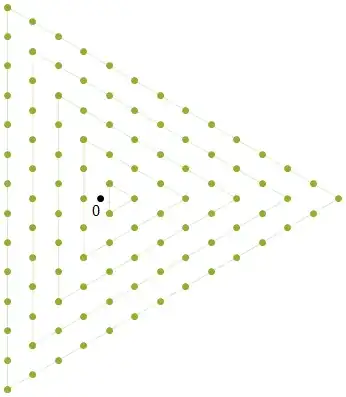

Now by noting that $\Lambda'$ can be decomposed into concentric "discrete regular triangles" centered at the origin, let $\Lambda'_N$ be the union of the first $N$ smallest triangles. For example, $\Lambda'_5$ is
In particular, each $\Lambda'_N$ is symmetric about a $\frac{2\pi}{3}$-rotation about the origin. Then by using the partial fraction decomposition

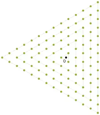

where $\tau = \frac{1}{\sqrt{3}} - \omega$ and $\Lambda''_N = \frac{1}{\sqrt{3}} - \Lambda'_N$. For example, $\Lambda''_5$ is:
Now by regrouping the dots in $\Lambda''_N$ into concentric regular triangles centered at the origin, we are left with $N-1$ triangles plus two extra "discrete lines", which we denote by $\gamma_N$. For example, the next picture demonstrates the decomposition of $\Lambda''_5$ into the triangles and $\gamma_5$:
