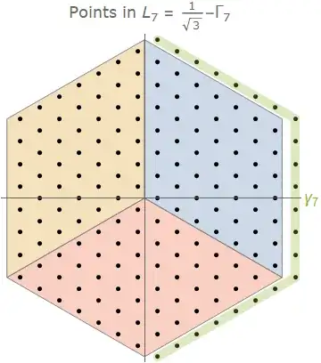

Now, the key observation is that most of the terms in the last sum cancel out. Indeed, the points in $L_N$ that lie in the hexagon spanned by vertices in $\Gamma_N$ are symmetric with respect to an $\frac{2\pi}{3}$-rotation about the origin:
Splitting L_7
This has to do with the fact that $\frac{1}{\sqrt{3}}$ is the center of the regular triangle with vertices $0$, $e^{i\pi/6}$, and $e^{-i\pi/6}$. So, if we write $\gamma_N$ for the points in $L_N$ that lies outside the hexagon spanned by $\Gamma_N$, then after the cancellation, we get
$$ S = \frac{3}{2\pi} \lim_{N\to\infty} \sum_{\tau\in \gamma_N} \frac{1}{\tau} = \frac{3}{2\pi} \lim_{N\to\infty} \sum_{\tau\in \gamma_N} \frac{1}{(\tau/N)} \cdot \frac{1}{N}. $$
Finally, write $z_0 = -i$, $z_1 = e^{-i\pi/6}$, $z_2 = e^{i\pi/6}$, and $z_3 = i$. Then by identifying this limit as a Riemann sum, $S$ reduces to the sum of three contour integrals:
\begin{align*} S &= \frac{3}{2\pi} \biggl( \frac{1}{z_1 - z_0} \int_{\overline{z_0 z_1}} \frac{\mathrm{d}z}{z} + \frac{1}{z_2 - z_1} \int_{\overline{z_1 z_2}} \frac{\mathrm{d}z}{z} + \frac{1}{z_3 - z_2} \int_{\overline{z_2 z_3}} \frac{\mathrm{d}z}{z} \biggr) \\ &= \frac{3}{2\pi} \biggl( \frac{i\pi/3}{z_1 - z_0} + \frac{i\pi/3}{z_2 - z_1} + \frac{i\pi/3}{z_3 - z_2} \biggr) \\ &= 1. \end{align*}
