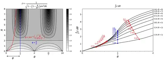

Plot: $$Z=\frac{1}{\sqrt{1-\left( 1- \frac{4}{R^2} \right) \sin^{2} \left( \theta\right)}}$$ enter image description here
Observations (from plot):
  • $F(a,b)$ from question is periodic with: $\pi$.
  • Integrating $\int Z \ d\theta$ gives $F(a,b)$ from $\varphi=0$ till $\varphi=\sin^{-1}\left(\sqrt{\frac{R}{R+2}}\right)$. $K(b)$ for $varphi=0$ till $\varphi=\pi/2$ giving: $F(a|b)=\frac{1}{2}K(b)$.
