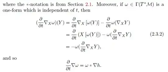

$\omega \in \Gamma(T^*M)$, $X,Y\in \Gamma(TM) $, $(M, g(t))$ is Riemannian manifold whoes metric depends on $t$. If I have $$ (\partial_t \nabla _X \omega)Y =-\omega(\partial_t \nabla_X Y) $$ Why $\partial_t \nabla \omega = \omega * \nabla (\partial _t g)$ ?
What I do: Assuming $\omega =\omega_i dx^i, X=x^i\partial_i, Y=y^i\partial_i$, I can get $$ -\omega(\partial_t \nabla_X Y) = -\omega_k x^i y^j \partial_t \Gamma_{ij}^k \tag{1} $$ I think (1) means that $\partial_t \nabla \omega = \omega * \nabla (\partial _t g) + \omega * (\partial_t g^{-1}\nabla g) $ by the definition of $\Gamma_{ij}^k$. Where is the wrong ?
Pictures belos are from Topping's Lectures on the Ricci flow, where $h=\partial_t g$.

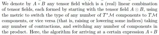

By the virtue of (2), the upper or lower position of the index is inessential in Riemannian geometry (cf. the musical isomorphisms), so that we can use $g^{a b}$ to get rid of the metric in the left hand side of (1). Furthermore, since the fields $X$, $Y$ and $Z$ are arbitrary, one can show (this is an exercise which can be performed by pure thought!), that (1) is equivalent to $$ \dot{\nabla}_a Y^b = (Y * \nabla h)_a{}^b \tag{3} $$ which is the Remark 2.3.3 in Topping's lectures (p.29 in my copy). See my answer regarding the meaning of $*$-notation.

The equation (2.3.2) in the lectures gives a clear calculation (abstract indices are less helpful in this case) for the identity $$ (\tfrac{\partial}{\partial t} \nabla_{X}\omega)(Y) = - \omega(\tfrac{\partial}{\partial t} \nabla_{X} Y) $$
which we can rewrite with abstract indices and our above conventions as $$ X^a Y^b \dot{\nabla}_{a} \omega_b = - X^a \omega_b \dot{\nabla}_{a} Y^b $$
Observing, that $X$ is arbitrary, and substituting (3) to eliminate $\dot{\nabla}_{a} Y^b$ from the RHS, in a similar fashion as above, we extract the sought formula: $$ \dot{\nabla}_a \omega_b = (\omega * \nabla h)_{a b} \tag{4} $$
