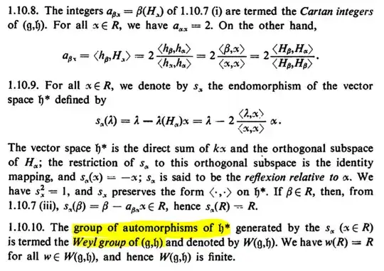

Then, in Dixmier´s book Enveloping algebras, I have seen this definition: Weyl group is a group of automorphisms of $\mathfrak{h}^*$. If we have a Lie algebra $\mathfrak{g}$, its Cartan subalgebra is denoted $\mathfrak{h}$ in the book, so $\mathfrak{h}^*$ should be functions from $\mathfrak{h}$. My question is whether this is true and how this definition belows connects with the other definition about isometries.
Thank you for advice, if there is any problem, I can edit. enter image description here

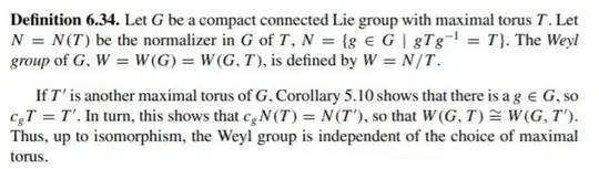

Edit: found another different definition of Weyl group. Let´s call it Definition 3, the isometry definition can be refered to as "Definition 1 and the $\mathfrak{h}^*$ definition can be "Definition 2". enter image description here
Note that $\mathfrak h^*$ is the dual of $\mathfrak h$, that is, it's the set of all linear maps from $\mathfrak h$ into the field that you are working with.
And those $s_\alpha$'s are reflections: if $\langle\lambda,\alpha\rangle=0$, then $s_\alpha(\lambda)=\lambda$. And if $\lambda$ is a multiple of $\alpha$, then $s_\alpha(\lambda)=-\lambda$. So, $s_\alpha$ is a reflection on the hyperplane $\{\lambda\in\mathfrak h^*\mid\langle\lambda,\alpha\rangle=0\}$.

And that is what your definition 2 talks about. It blurs a little the distinction between the abstract ambient vector space $E$ of an abstract root system and the ambient vector space $\mathfrak h^*$ of the concrete root system $R$ of the Lie algebra constructed there. Technically, one would have to use something like $E := ( \mathbb R-$span of $R$ inside $\mathfrak h^*$) here. The Weyl group consists of automorphisms of this, but after a little practice, one sees that one can equivalently just talk of automorphisms of $\mathfrak h^*$; what is important, actually, is that the Weyl group induces isometric automorphisms (self-bijections) of our crystal $R$, the root system itself!
Finally, definition 3 lives in the even greater setting of Lie groups. Again, somewhere in the group there sits (as a hidden "skeleton") a certain root system. And with a lot of work one can see: The Weyl group of that root system (in the abstract sense of definition 1) can also be seen in a seemingly very different place: It is isomorphic to a certain quotient of a certain normalizer of a certain subgroup of the group we are studying. That these two ways of defining "the" Weyl group in this setting are equivalent is not at all trivial, but a very rewarding goal to understand through self-study. Do not expect it to be easily visible in any way. Maybe the first thing would be to go through all these definitions in certain easy examples with matrices, say the Lie group $G= SU(2)$, or the Lie algebra $\mathfrak g = \mathfrak{sl}_2(\mathbb C)$ with $\mathfrak h$ the diagonal matrices. Once you see what the roots here are (there's only two, and they are negatives of each other), and what the Weyl group is (in every definition, in the end it's just two automorphisms, one the idnetity and one the switching of those two roots); then you can go to $SU(3)$ and $\mathfrak{sl}_3$, and now things should become interesting. (Six roots, Weyl group consists of six isometries.)
