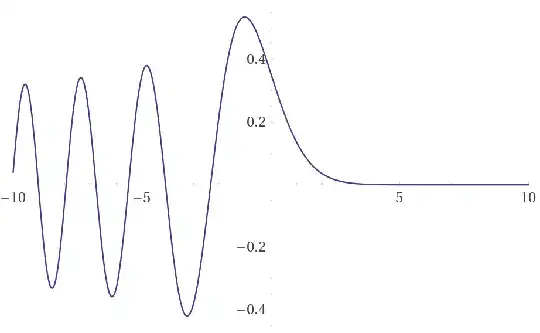

Here is a graph of the summand: enter image description here

  • Don't you get $1$ when you add up the two Abel-Plana results and subtract the extra $\operatorname{Ai}(0)$? The integrals just cancel each other out. – Gary Sep 17 '21 at 00:34
  • @Gary This formula implies that the sum over the integers is just the area under the function, so the sum is the same as the integral. Good observation. I used it in the problem. The formula does not always work. – Тyma Gaidash Sep 17 '21 at 00:56
    $\operatorname{Ai}(\pm ix)$ grows too fast for the Abel-Plana to be applicable. – metamorphy Sep 17 '21 at 04:03
  • I don't even see a clearway justification that $\sum_{n=-\infty}^{-1}\operatorname{Ai}(n)$ converges. According to the asymptotics, this is equivalent to the convergence of $\sum_{n=1}^\infty\frac1{n^{1/4}}\sin\left(\frac23 n^{3/2}+\frac\pi4\right)$, which is not at all obvious. (And I don't trust your numerical experiments not related to regularised things.) – metamorphy Sep 22 '21 at 15:37
  • Just for fun, this is the partial sum plot of your sine series. – Тyma Gaidash Sep 22 '21 at 17:31
    Linking to this question (the convergence issue is still open). – metamorphy Jul 27 '22 at 03:59
  • @metamorphy Using $\sum_{n=1}^\infty \frac{\sin(n^a)}{n^b}$ converging if $b>\max(a,1-a),a>0$, the sum is $\frac1{\sqrt 2}\sum_{n=1}^\infty \frac{\sin(\frac23n^{3/2})}{n^\frac14}+\frac1{\sqrt2} \sum_{n=1}^\infty \frac{\cos(\frac23n^{3/2})}{n^\frac14}$. However, $\sum_{n=1}^\infty \frac{\sin(m n^a)}{n^b}$ and $\sum_{n=1}^\infty \frac{\cos(m n^a)}{n^b}$’s convergence is unknown – Тyma Gaidash Jul 27 '22 at 13:16
