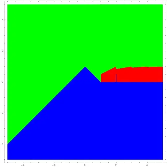

Easy cases
  • $\forall\,a \in \mathbb{R}$ we have $\left|\frac{\sin\left(n^a\right)}{n^b}\right| \le \frac{1}{n^b}$ so the series $\color{green}{\text{converges}}$ for $b > 1$.
  • If $a \le 0$ we have $\frac{\sin\left(n^a\right)}{n^b} \le \frac{1}{n^{b-a}}$ so the series $\color{blue}{\text{diverges}}$ for $b \le a + 1$ and $\color{green}{\text{converges}}$ for $b > a + 1$.
  • If $a > 0 \, \land \, b \le 0$ we have $\not\exists \begin{aligned}\lim_{n \to \infty} \frac{\sin\left(n^a\right)}{n^b} \end{aligned}$ so the series $\color{blue}{\text{diverges}}$.
  • If $a = 1\, \land \, b > 0$ the series $\color{green}{\text{converges}}$ by Abel-Dirichlet's test.
Hard cases
  • If $0 < a < 1\, \land \, 0 < b \le 1-a$ the series $\color{blue}{\text{diverges}}$ by proof of i707107.
    • If $0 < a < \frac{1}{2}\, \land \, a < b \le 1-a$ the series $\color{blue}{\text{diverges}}$ by proof of RRL.
  • If $0 < a < 1\, \land \, b > 1-a$ the series $\color{green}{\text{converges}}$ by proof of i707107.
    • If $a > 0\, \land \, b > \max(a,\,1-a)$ the series $\color{green}{\text{converges}}$ by proof of RRL.
  • If $k \in \mathbb{Z}_{\ge 2}, $ $k-1 < a < k\, \land \, b > 1 - \frac{k-a}{2^k-2}$ the series $\color{green}{\text{converges}}$ by proof of i707107.
  • If $a > 0 \, \land \, b = 1$ the series $\color{green}{\text{converges}}$ by proof David Speyer (+ i707107 in the comments).
  • If $a = 2 \, \land \, 0 < b \le \frac{1}{2}$ the series $\color{blue}{\text{diverges}}$ (Theorem 2.30 by Hardy&Littlewood).
$\color{red}{\textbf{Open cases}}$

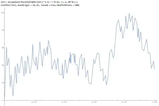

  • $a = \frac{3}{2} \land b = \frac{1}{4}$: enter image description here

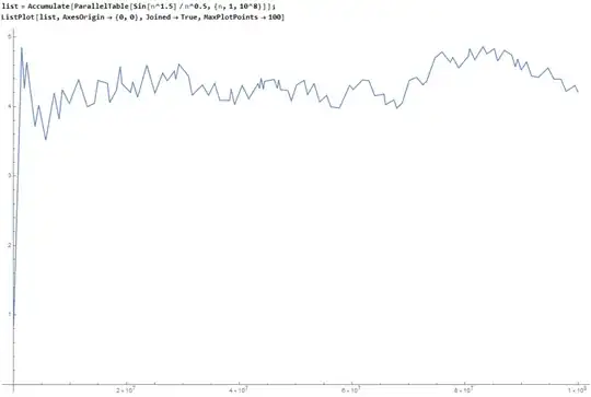

  • $a = \frac{3}{2} \land b = \frac{1}{2}$: enter image description here

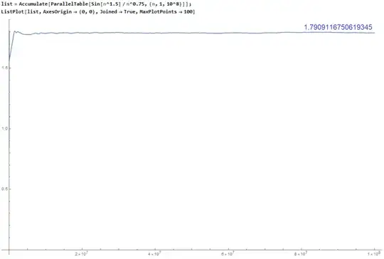

  • $a = \frac{3}{2} \land b = \frac{3}{4}$: enter image description here

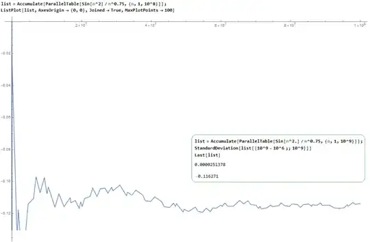

  • $a = 2 \land b = \frac{3}{4}$: enter image description here

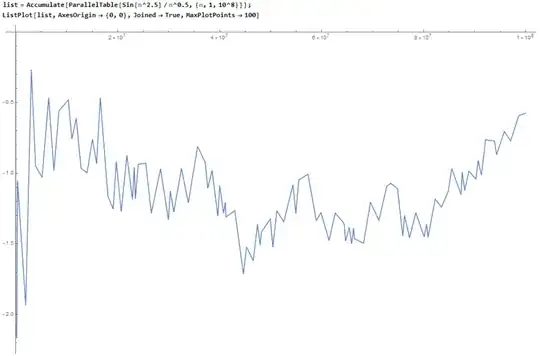

  • $a = \frac{5}{2} \land b = \frac{1}{2}$: enter image description here
