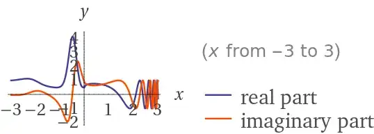

Here is the graph over the real line of the integrand: enter image description here
