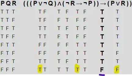

  4. Your argument in (c) is fallacious for the same reason.
    Instead, the truth assignment $(P,Q,R)=(F,F,F)$ immediately disproves conclusion (c).

  • Why did we use the truth assignment (P, Q, R) = (T, T, T) to disprove (b), but (P, Q, R) = (F, F, F) to disprove (c)? – Sokhibjon Zamonov Aug 27 '21 at 05:20
  • @SokhibjonZamonov Each of those two sets happens to be the only one that works for the respective conclusion. I just added the truth table for (c); try constructing a similar one for (b). (This tool is handy. I've also added link in Point 1.) – ryang Aug 27 '21 at 05:49
