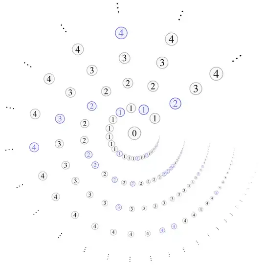

Finally, here's a picture I drew of the tensor product $\N\otimes_{\F_{1}}\N\cong(\N\setminus\{0\},\cdot)^{\oplus{\N}}\coprod\{0\}$, where $\mathbb{N}$ is the multiplicative monoid of natural numbers:
Here the blue circles depict the element $(2$, $1$, $4$, $1$, $2$, $3$, $4$, $2$, $2$, $1$, $2$, $3$, $2$, $1$, $4$, $4$, $1$, $2$, $2$, $2$, $2$, $4$, $3$, $1$, $3$, $2$, $1$, $3$, $4$, $2$, $2$, $2$, $3$, $3$, $4$, $2$, $1$, $2$, $1$, $2$, $2$, $2$, $\ldots)$ of $\N\otimes_{\F_{1}}\N\cong(\N\setminus\{0\},\cdot)^{\oplus{\N}}\coprod\{0\}$, represented as a counterclockwise spiral.
(Note that the factors of $\mathbb{N}$ in the above direct sum carry the multiplicative monoid structure, not the additive one!)
We can then picture $\Z\otimes_{\F_{1}}\Z\cong(\Z\setminus\{0\},\cdot)^{\oplus{\N}}\coprod\{0\}$ in a similar way, adding negative numbers to the above image.
