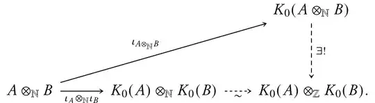

$\newcommand{\Q}{\mathbb{Q}}\newcommand{\N}{\mathbb{N}}\newcommand{\Z}{\mathbb{Z}}$Recall the definitions of the tensor product $\otimes_{\mathbb{N}}$ of commutative monoids (see also this note by Harold Simmons) and of the Grothendieck group $K_0$ of a commutative monoid (see also wikipedia). Given commutative monoids $A$ and $B$, we can apply the universal property of $K_0$ to the diagram
to get a morphism of abelian groups $$K^{\otimes}_{0|A,B}\colon K_{0}(A\otimes_{\mathbb{N}}B)\to K_{0}(A)\otimes_{\mathbb{Z}}K_{0}(B).$$ Since we also have an isomorphism $K^{\otimes,1}_{0}\colon K_{0}(\mathbb{N})\overset{\sim}{\dashrightarrow}\mathbb{Z}$, these morphisms endow $K_{0}$ with the structure of an oplax monoidal functor $$ (K_{0},K^{\otimes}_{0},K^{\otimes,1}_{0}) \colon (\mathsf{CMon},\otimes_{\mathbb{N}},\mathbb{N}) \longrightarrow (\mathsf{Ab},\otimes_{\mathbb{Z}},\mathbb{Z}). $$ (I think―I haven't actually checked the coherence conditions.)
Now, I'm quite confident that the map $K^\otimes_{0|A,B}$ is not always an isomorphism, so I'm trying to come up with a counterexample. Am I correct in thinking that $A=B=(\mathbb{Z},\cdot,1)$ is such an example?

In fact, the canonical map $K_{0}(A\otimes_{\mathbb{N}}B)\to K_{0}(A)\otimes_{\mathbb{Z}}K_{0}(B)$ is always an isomorphism. One way to see this is by observing that if $M$ is a commutative monoid then $K_0(M)$ is naturally isomorphic to $\mathbb{Z}\otimes_{\mathbb{N}} M$ (where here $\mathbb{Z}$ is the additive monoid). You can prove this, for instance, by verifying that bilinear maps $\mu:\mathbb{Z}\times M\to N$ are in natural bijection with homomorphisms $f:M\to N$ that send each element of $M$ to an invertible element (by defining $\mu(a,m)=af(m)$ in one direction and defining $f(m)=\mu(1,m)$ in the other direction).
So, $$K_0(A\otimes_\mathbb{N} B)\cong \mathbb{Z}\otimes_\mathbb{N} A\otimes_{\mathbb{N}} B\cong (\mathbb{Z}\otimes_\mathbb{N}\mathbb{Z})\otimes_\mathbb{N} A\otimes_{\mathbb{N}} B\cong (\mathbb{Z}\otimes_\mathbb{N} A)\otimes_\mathbb{N}(\mathbb{Z}\otimes_\mathbb{N} B)\cong K_0(A)\otimes_\mathbb{N} K_0(B).$$ Since $\otimes_\mathbb{N}$ is the same as $\otimes_\mathbb{Z}$ when applied to commutative monoids that are actually already groups, this gives an isomorphism $K_{0}(A\otimes_{\mathbb{N}}B)\to K_{0}(A)\otimes_{\mathbb{Z}}K_{0}(B)$. It is then a matter of definition-chasing to confirm that this isomorphism is the same as the map you are considering (for instance, by verifying that they both send elements of the form $[a\otimes b]$ (which generate the group $K_{0}(A\otimes_{\mathbb{N}}B)$) to $[a]\otimes [b]$)).
There are several errors in your proposed example. I'm not sure how you got that $\mathbb{Z}\otimes_\mathbb{N}\mathbb{Z}\cong\mathbb{Z}\oplus\mathbb{Z}_2$; this does not seem correct since (for instance) the elements $p\otimes -1$ should be distinct invertible elements of $\mathbb{Z}\otimes_\mathbb{N}\mathbb{Z}$ for each prime $p$ whereas $\mathbb{Z}\oplus\mathbb{Z}_2$ has only finitely many invertible elements (assuming you mean the $\mathbb{Z}$ there to still be the multiplicative monoid). Also, $K_0(\mathbb{Z})=0$, not $\mathbb{Q}$, since adjoining an inverse to $0$ kills everything ($0\cdot x=0$ implies $x=1$ if $0$ becomes invertible).
