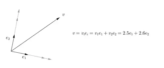

a covector, say $\omega$ for example, isn't just a function $\omega:V \to \mathbb{R}$ that takes a vector and gives a real number. it has to be linear. as for $u,v\in V$ and $a,b \in \mathbb{R}$: $$\omega(av+bu)=a\omega(v)+b\omega(u)$$ this property has nice consequences. you probably know that in a vector space, for example the vector space of directed line segments on the $\mathbb{R}^2$ plane, you can choose a set of linearly independent vectors and and express any other vector as a linear combination of them. for example $v$ here can be written as a linear combination of $\{e_1,e_2\}$. enter image description here so if we applied our function $\omega$ on $v$ using the linearity property : $$\omega(v)=\omega(v_ie_i)=\omega(v_1e_1+v_2e_2)=v_1\omega(e_1)+v_2\omega(e_2)$$ let $\omega_i=\omega(e_i)$ be the value of $\omega$ applied on our chosen basis $\{e_1,e_2\}$. so: $$\omega(v)=\omega_1v_1+\omega_2v_2$$ so if you want to express any vector as linear combination of these two basis vectors. the value of $\omega$ applied at this vector can be easily calculated if you know its value at the chosen basis. Now, why are these kind of functions called covectors? well consider these two linear functions $\{\theta_1,\theta_2\}$: $$\theta_1(e_1)=1 \; ; \; \theta_2(e_1)=0 \; ; \; \theta_2(e_1)=0 \; ; \; \theta_2(e_2)=1$$
applying $\theta_i$ to a vector $v$ gives us the $i$-th component of it: $$\theta_1(v)=v_1\theta_1(e_1)+v_2\theta_1(e_2)=v_1 \\ \theta_2(v)=v_1\theta_2(e_1)+v_2\theta_2(e_2)=v_2$$
so:
$$\omega(v)=v_1\omega_1+v_2\omega_2=\omega_1 \theta_1(v)+\omega_2 \theta_2(v) = (\omega_1 \theta_1+\omega_2 \theta_2)(v)$$
so the linear function $\omega$ can be expressed as a linear combination of $\{\theta_1,\theta_2\}$. so this set of linear functions can be added, scalar-multiplied and be written as a linear combination of two "basis" linear functions. so they form a vector space called the dual space to $V$ and has the symbol $V^*$.
but what if we choose other basis instead of $\{e_1,e_2\}$? how will the components of $v$ change? how will the dual vector basis $\{\theta_1,\theta_2\}$ change? this is the topic of the youtube series you are following now which I assume is eigenchris's series and I think he does a beautiful job explaining this.
in this answer I assumed that you know at least "classical" vectors, directed line segments, and how to add and scale them and what is a linear combination. hope this was helpful.
