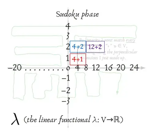

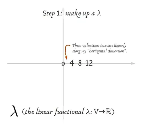

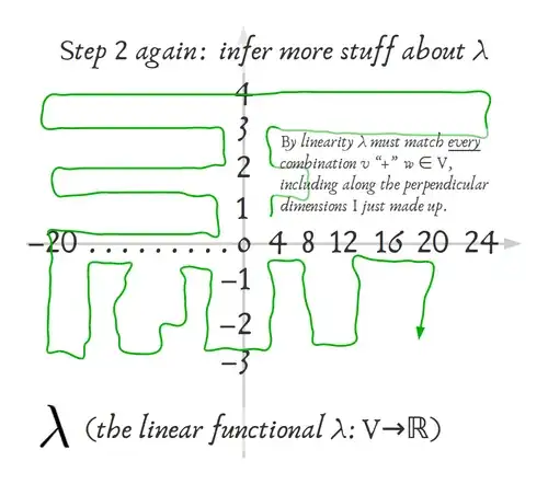

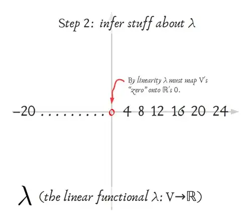

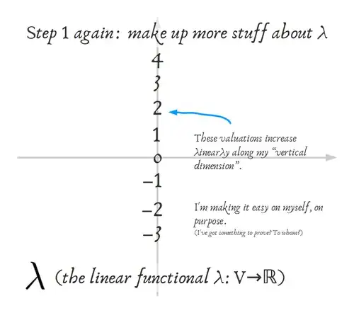

Covectors are weighted averages.
Keep the same data $\vec{x}$, the same style of inner product, $$\alpha_1 \cdot x_1 + \alpha_2 \cdot x_2 + \alpha_3 \cdot x_3 \ldots$$ but change the $\alpha_i$ in the above expression. This is "adjusting weights" in everyday parlance or "moving the covector" in mathematical words. People really do do this all the time, so it's not esoteric or merely-academic. (Notice that after I sum the product-pairs I'll have one scalar answer. I've "reduced" dimension to 1 in a "map-reduce" sense. This is the way inner products work.)

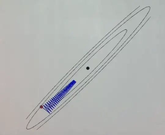

You can also use the visual of a loss function ellipsy loss function to centre yourself in "parameter space". Think about you have a model with a given form $$\alpha_1 \cdot \phi_1(\vec{x}) + \alpha_2 \cdot \phi_2(\vec{x}) + \alpha_3 \cdot \phi_3(\vec{x}) + \ldots$$ for example the $\phi_i$ could be basis functions. Adjusting the weights $\alpha_i$ is the goal of statistical modelling. For example the OLS solution picks an "optimal" covector (in some sense of the word "optimal"). standard regression problem, in y ~ x space but could be a linear functional space And gradient descent on some kind of model that can be parameterised by "summed weightings of [stuff]" is also shooting for the same goal by exploring the covector space.
Regarding your question about $dx_i$ (projection functions on the $i$th dimension: forgetting every other coordinate but the $i$th). Go back to the top equation I wrote $\sum \alpha_i \cdot x_i$. Set all of the $\alpha_i$'s to zero except for $\alpha_1$. Now as you increment $\alpha_1$ what happens algebraically? You get $$\{\alpha_1=1\} \implies \sum=x_1; \quad \{ \alpha_1=2\} \implies \sum=2x_1; \quad \cdots $$ (What is that geometrically? It's slopes increasing the same way as in calc 101. Except we'll be able to combine that with the outcomes of the other $\alpha_{j\neq 1}$ in a second) If you set any of the $\alpha_{j \neq i}$ to zero and raised one "slider" $\alpha_i$ at a time you'd find the same thing. And because of linear-algebra I know I can, except in a few bad cases, "straighten" the basis so it's orthonormal (unshear, rotate, whatever...Gram-Schmidt fixes it automatically), meaning the $\alpha_i$'s will operate independently (linearly-independently--sum-of-products style) of each other and you can actually infer every number in the induced scalar-field all over the space, from the axes (even from just the first step out on any given axis).

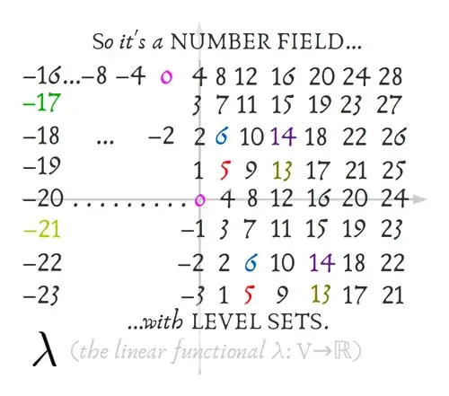

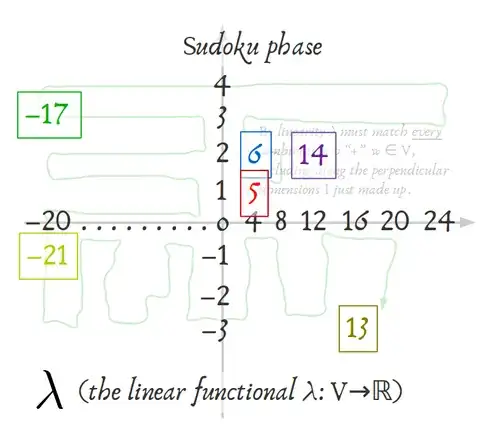

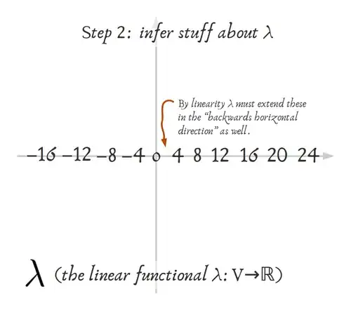

I found it helpful to draw a plane and work it out by hand (I agree with you, @Mike, that $\mathbb{R}^2$ is the way to start) with a really simple example.
linear-functional sudoku
In the example I drew, I chose $\alpha_1=4$ and $\alpha_2=1$ but the point is that, however you do this,
linear-functional suduku lfsu lsfu sflu usfl sufl
Eventually as I unwind the definition more-and-more, with really simple numbers on something drawable, I found the familiar "level sets" -- so the linear structure is showing up again in the scalar-field (dual space). Yay!
level sets
And as you think about the ways this scalar-field could change (what would have happened if you changed some of the $\alpha_1 \text{ or } \alpha_2$), you might start to see why Wikipedia used the stack-of-hyperplanes visual for their entry....
hyperplanes
HTH
