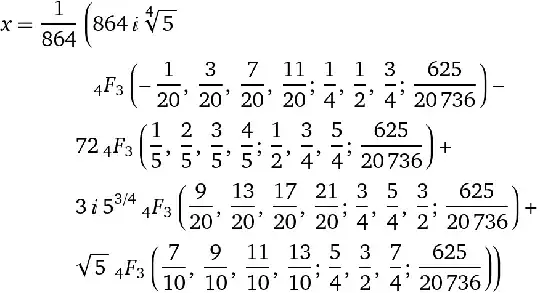

Here are the other solutions of which I am unsure how to derive. The complex solution is also the conjugate of the one posted. Notice the similar hypergeometric arguments:
$$\mathop =_{\text{conjugate}}^{\text{with}}-.080931889…\pm 1.5063232344…i$$

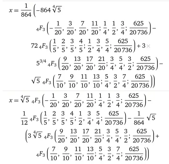

Other real solutions:enter image description here
Top=$-1.56912279…$, Bottom=$1.39681985…$
I would write out the rest of the roots the same way and using the continued fraction formula in the Wolfram functions site link, but these are too complicated. If someone else wants to write them out, be my guest. The same goes for the nome representation. I hope this helps. Please correct me and give me feedback!
