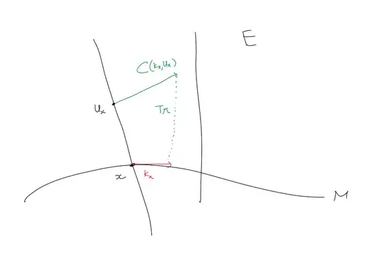

Geometrically this definition makes sense; I interpret $C(k_x,u_x)$ as "the direction I should move within $E$ in order to reach an infinitesimally close fiber, provided that I start at the point $u_x$ of the fiber $E_x$, and move in the direction $k_x$ in the base manifold" (picture below for one-dimensional base and fibers).

Picture:
Connections
peek-a-boo
