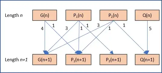

Taking strings containing $122$ as "qualifying", I identify $4$ states to track for each length of string:
  • General non-qualifying strings that doesn't end in $1$ or $12$, quantity "$G$"
  • Non-qualifying strings that end in $1$, quantity "$P_1$"
  • Non-qualifying strings that end in $12$, quantity "$P_2$"
  • Qualifying strings, quantity "$Q$"
Then the transition from one length to the next looks like this:
that is
  • $G(n+1) = 4G(n)+3P_1(n)+3P_2(n)$
  • $P_1(n+1) = G(n)+P_1(n)+P_2(n)$
  • $P_2(n+1) = P_1(n)$
  • $Q(n+1) = P_2(n)+5Q(n)$
Non-qualifying strings in general are $G+P_1+P_2$, quantity "NQ", so $P_1(n) = NQ(n-1)$
Then substituting $P_1(n-1) = NQ(n-2)$ for $P_2(n)$ we have
  • $G(n+1) = 4G(n)+3P_1(n)+3P_2(n) = 4NQ(n)-NQ(n-1)-NQ(n-2)$
  • $P_1(n+1) = NQ(n)$
  • $P_2(n+1) = NQ(n-1)$
  • $\color{#0b2}{NQ(n+1) = 5NQ(n) - NQ(n-2)}$
  • $\color{#0b2}{Q(n+1) = 5Q(n) + NQ(n-2)}$
