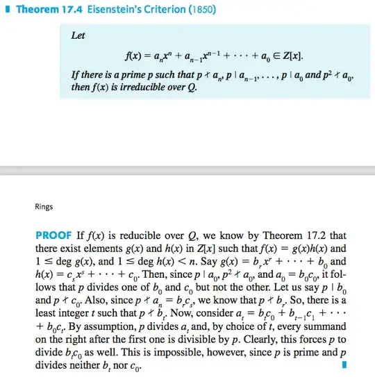

I'd like to find a proof (as simple as possible) of Eisenstein's criterion of irreducibility. I found here the proof in the picture below. This is rather elegant, yet I do not understand why $g,h$ must have integer coefficients.
Edit:
I found this paper, stating
If a polynomial with integer coefficients is reducible over Q, then it is reducible over Z.
A proof of this is not given though
  • The proof mentions Theorem 17.2 in which apparently the coefficients being integers is shown. – coffeemath Mar 27 '21 at 12:24
  • @coffeemath I see that, but I don't have the book, so I don't have this theorem nor its proof – Ariel Yael Mar 27 '21 at 13:11
  • That reducibility over $\mathbb{Q}$ for a polynomial with integer coefficients implies reducibility over $\mathbb{Z}$ is a result sometimes called “Gauss’s Lemma”, and is a consequence of the fact that product of primitive polynomials is primitive (see Gauss’s proof here. I’m afraid that if you don’t have it, you’ll add a page or so to the proof. – Arturo Magidin Mar 27 '21 at 17:09

    Yes, $3x+3 = 3(x+1)$, which is a product of two irreducibles of $\mathbb{Z}[x]$, so it is reducible in $\mathbb{Z}[x]$. But it is not primitive. A primitive polynomial with integer coefficients is irreducible over $\mathbb{Z}$ if and only if it is irreducible over $\mathbb{Q}$. A nonprimitive polynomial with integer coefficients is never irreducible over $\mathbb{Z}$/ – Arturo Magidin Mar 27 '21 at 19:36

This has to do with Gauss's Lemma for polynomials. It states that a primitive polynomial is irreducible over the integers if and only if it is irreducible over the rational numbers.
So in the given proof, they assume that it is reducible over integers to achieve a contradiction in order to prove that it is irreducible over the integers, and hence also over the rationals.
