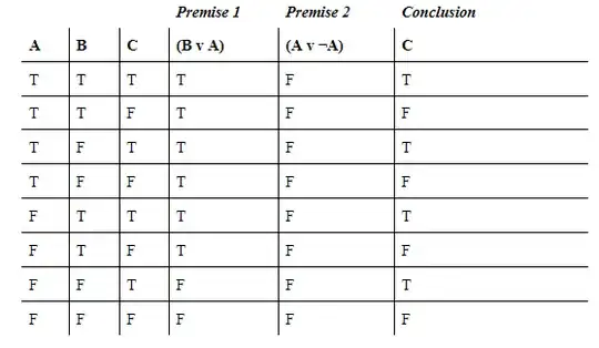

I'm trying to determine the validity of the argument tabulated below. Note: Premise 2 is meant to read as (A ∧ ¬A). My bad!
truth table
Consider the final two rows: can an argument still be valid even if either (1) all the premises are false but the conclusion is still true or (2) the premises and conclusion are all false?
Furthermore, is an argument automatically invalid if it lacks any row in which the premises and conclusion are all true?
I would like to make it clear that I do understand that I do understand that an argument is invalid if its truth table contains a row where the premises are all true but the conclusion is false.

I can't quite make sense of the title and your first question -- true or false where, i.e. under which interpretation? What we need to check is that truth is preserved from the premises to the conclusion under all possible interpretations:
An argument is valid iff
there is no row where all premises are true and the conclusion is false.
We can not determine from a single row with false premises whether the argument is valid or not. Rows where at least one of the premises is false count positive towards the validity, the truth value of the conclusion does not matter in these cases. The only thing that must not happen is for there to be a row where all premises are true but the conclusion is false: We have "if and only if a truth table contains a row in which all premises are true but the conclusion is false the argument is invalid".
This means in particular that if there is no row that makes all premises true to begin with, because the premises are contradictory, then there can be no counterexample. In this case, the argument is (vacuously) valid.
So your argument is valid because there is no counter example where all premises are true but the conclusion is false.

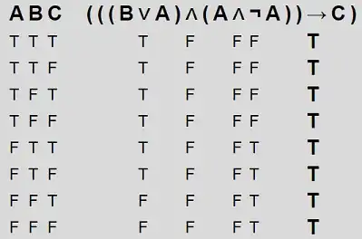

Here is the truth table of the statement you present in your question:
Truth Table from
Source: https://www.erpelstolz.at/gateway/TruthTable.html
Notice that antecedent is always false (column 5). Therefore, by the so-called principle of explosion, the implication (last column) will always be true.
This does not mean that the consequent C (in your example) is always true. As you can see, it is false in the half the cases presented here (column 3).
