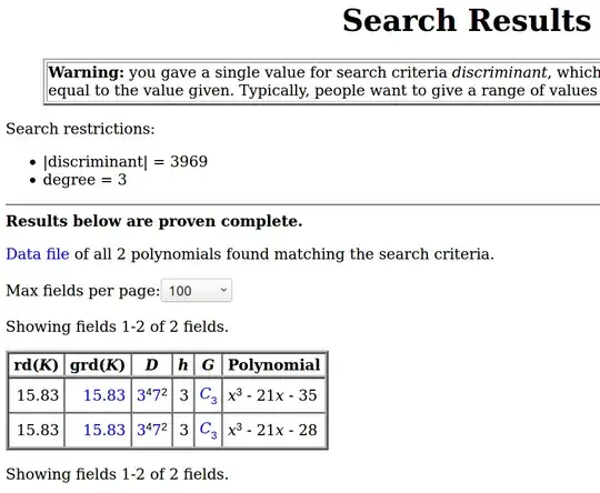

The two examples from the field database represent $1, 8, 55, 62 \pmod {63} $ Taken as polynomials, the second discriminant is $4$ times the first.

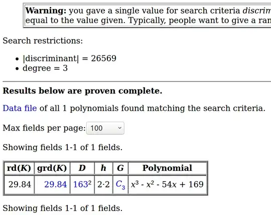

The counterexample of Pisco is cubic, discriminant $163^2$ while the Hilbert class field has degree 12 and is not abelian. All words to look up, I have Cox

If $K/\mathbb{Q}$ is an abelian cubic field, then your assertion is true for $K$ (i.e. prime represented can be expressed via congruence) iff its Hilbert class field $H$ is abelian over $\mathbb{Q}$. This is true for all cubic fields you cited: $$x^3-3x+1\qquad x^3+x^2-2x-1\qquad x^3-21x-35\qquad x^3-21x-28$$ But false in general, for example, the Hilbert class field (degree $12$) of $x^{3} - x^{2} - 54 x + 169 $ is not abelian over $\mathbb{Q}$.

  • @WillJagy You certainly have more expertise than me in language in the forms, I could not understand most of your remarks, but your added remarks on $q$ seem interesting. Regarding Hilbert class field of the cubic I suggested, I don't know its explicit form, but one can already infer from information given in LMFDB page that it is non-abelian: if it were, then we would have $H\subset \mathbb{Q}(\zeta_{163})$, but $12\nmid \varphi(163)$. – pisco Dec 27 '20 at 15:48
  • Finally got the machinery working. For your $163^2$ polynomial $x^3 + x^2 - 54 x - 169,$ the primes $p$ over which it is irreducible $\pmod p$ are precisely the primes for which the constructed norm form can only be divisible by $p$ when all of $x,y,z$ are so divisible. This does not seem to work out for $x^3 - 3x + 1.$ Seems the trouble is when the discriminant, still a square, is not the square of a prime. – Will Jagy Dec 31 '20 at 21:05
