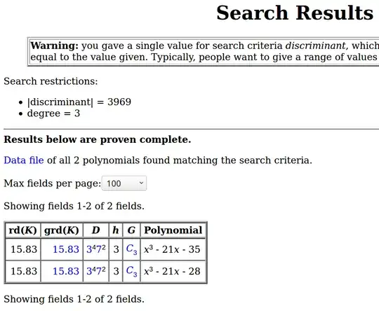

Let $\alpha$ be a root of the polynomial $x^3-21x-35=0$, and let $K:=\mathbb{Q}(\alpha)$. Then it is easy to show that $$Norm(x+y\alpha+z\alpha^2)=x^3+35y^3+1225z^3-105xyz-21xy^2+441xz^2+42x^2z-735yz^2.$$ That Binary cubic form is just $Norm(x+y\alpha)$.
Note that the discriminant of $P(x)=x^3-21x-35$ is $-(4\times(-21)^3+27\times(-35)^2)=3969=3^4\times7^2$, so discriminant of $K$ is a square, so it is a cyclic cubic Galois extension, so we can conclude that $r_1=3$ and $r_2=0$. By Dirichlet's unit theorem, we can conclude that $\mathcal{O}_K^{\times}=\{\pm1\}\times\mathbb{Z}^2$. Also, note that $P(x)=x^3-21x-35$ is $7$-Eisenstein, and $P(x-1)=x^3-3x^2+3x-1-21x+21-35=x^3-3x^2-18x-15$ is $3$-Eisenstein; so we can conclude that $\mathcal{O}_K=\mathbb{Z}[\alpha]=\mathbb{Z}\oplus\mathbb{Z}\alpha\oplus\mathbb{Z}\alpha^2$.
Is the answer to the following question positive?
Assume that $Norm(a+b\alpha+c\alpha^2)=p$. Does there exist a unit $u \in \mathcal{O}_K^{\times}$ such that $(a+b\alpha+c\alpha^2)\times u = A+B\alpha$ for some integers $A, B$? Assume that $a+b\alpha+c\alpha^2$ is given. Can we find a suitable unit, such that after the multiplication, we can write the product as linear combination of $1$, and $\alpha$? without need of $\alpha^2$?

    @StinkingBishop Let $\alpha$ be a root of the polynomial $x^3-21x-35=0$, and let $K:=\mathbb{Q}(\alpha)$. Then it is easy to show that $$Norm(x+y\alpha+z\alpha^2)=x^3+35y^3+1225z^3-105xyz-21xy^2+441xz^2+42x^2z-735yz^2.$$ That Binary cubic form is just $Norm(x+y\alpha)$. – Davood Dec 26 '20 at 13:31
Let $\alpha$ be a root of $x^3-21x+35=0$. Then it is easy to characterize primes of form $$N(x + y\alpha + z\alpha^2) = x^3+35y^3+1225z^3-105xyz-21xy^2+441xz^2+42x^2z-735yz^2$$ which was already eluded in Will Jagy's answer.
(Theorem) A prime $p\neq 3,7$ can be represented by above cubic form iff $p\equiv \pm 1, \pm 8 \pmod{63}$.
Proof of Theorem: Let $K$ be number field of $x^3-21x+35$. I assume the following facts: $K$ has class number $3$, contained in $\mathbb{Q}(\zeta_{63})$.
Let $H$ be the Hilbert class field of $K$, then $H/\mathbb{Q}$ is abelian of degree $9$ ($H/\mathbb{Q}$ is Galois and any group of order $9$ is abelian).
  1. Claim: $H\subset \mathbb{Q}(\zeta_{63})$. This follows from a general (but not well-known) fact of cyclotomic fields. We have the following proposition, proved in the answer here: If $F/\mathbb{Q}(\zeta_m)$ is unramified (at finite primes) and $F/\mathbb{Q}$ abelian, then $F=\mathbb{Q}(\zeta_m)$. Because $H/\mathbb{Q}$ is abelian, applying this proposition to $F=H\mathbb{Q}(\zeta_{63})$ shows that $H\mathbb{Q}(\zeta_{63}) = \mathbb{Q}(\zeta_{63})$, so $H\subset \mathbb{Q}(\zeta_{63})$.
  2. Claim: $H$ corresponds to $\{\pm 1,\pm 8\} \subset (\mathbb{Z}/63\mathbb{Z})^\times$. $H$ corresponds to a subgroup of order $4$ of $(\mathbb{Z}/63\mathbb{Z})^\times = C_6 \times C_6$, such a subgroup is unique, and this is the only one.
Finally $p\neq 3,7$ can be represented as $N(x + y\alpha + z\alpha^2)$ iff $p$ splits into principle ideals in $K$, iff $p$ splits completely in $H$, completing the proof.

Note that $x^3 - 21 x + 35$ and $x^3 - 21 x + 28$ give different fields

  • What I know: The ideal class group is $\dfrac{\mathbb{Z}}{3\mathbb{Z}}$, and $K$ is an Abelian extension. How do we know that the Hilbert class field is an Abelian extension? The congruences you wrote, form a subgroup of index $3$ in the group $(\dfrac{\mathbb{Z}}{63\mathbb{Z}})^{\times}$. I can realize why should we consider a subgroup of index $3$, but I do not understand how we got to this group $(\dfrac{\mathbb{Z}}{63\mathbb{Z}})^{\times}$? Could you please introduce me to a good reference on the subject? – Davood Dec 26 '20 at 21:12
  • I do not understand how you got to that group of cardinality $12$ of some residues modulo $63$? And how did you find that subgroup of cardinality $4$? and why $63$? because $63 \times 63$ equals the discriminant? – Davood Dec 26 '20 at 21:24
  • @DavoodKHAJEHPOUR I missed another restriction; the primes represented are $\pm 1 \pmod 7$ and $\pm 1 \pmod ,$ for $ 1, 8, 55, 62 \pmod {63}$ The two conditions can be seen separately by $x^3 - 3x+1$ of discriminant $81$ and $x^3 + x^2 - 2x - 1$ of discriminant $49$ I knew these, but are in the tables in Henri Cohen, A course in Computational Algebraic Number Theory, in back, B.4, totally real cubic fields. – Will Jagy Dec 26 '20 at 21:24
  • @DavoodKHAJEHPOUR meanwhile, all this is precisely because the discriminant is $63^2$ We should expect $x^3 - 21 x + 28$ norm form to likewise represent a subgroup of the multiplicative group of integers $\pmod {63} $ I would guess that you would benefit from resources on cyclotomic fields; these fields are related to those; note your Galois group is cyclic, the roots are finite sums of cosines of selected $2 \pi k / 63.$ Meanwhile, it should be worthwhile to look into the compositum construction for the indicate fields with discriminants $49, 81.$ – Will Jagy Dec 26 '20 at 21:35
