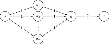

Since you want to have exponentially many maximal flows, one way to construct it is to give many choice at first then to make a bottleneck.
As the original question asked to construct a graph for an arbitrary $n$, we will give a whole family of graphs $(G_n)_n$ with $G_n$ having (roughly) $n$ vertices and around $2^n$ different maximal flows(the graphs will actually have $n+1$ vertices plus the source and the sink, but it doesn't matter for the asymptotic):
Le $G_n$ be the following graph : a graph having an exponential number of maximal flows
its quite clear that a maximal flow has a capacity of $n \over 2$, now, one as to chose which vertices $a_i$ to visit for the flow. Clearly there is $\binom{n}{n/2}$ possible choice, meaning that there are $\binom{n}{n/2}$ different maximal flows. The asymptotics of this number is $2^n$ (see limit of $2n$-th root of $2n$-th central binomial coefficient -- $\lim_{n\to \infty}{2n \choose n}^{\frac{1}{2n}}$ for instance)
You can get more precise estimate on the number of flows but I hope this is more or less what you've asked.

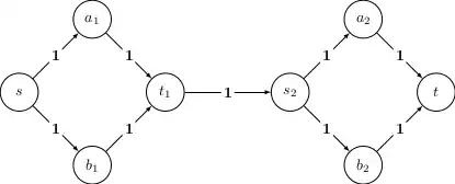

the following graph graph with 8 vertices and 4 maximal flows
has graph with $8=2\times 4$ vertices and $4=2^2$ maximal flows.

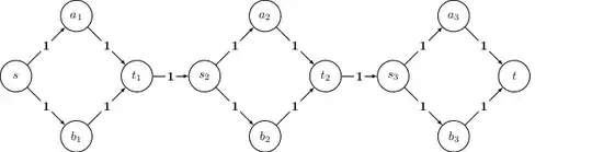

Using three times this diamond shaped graph we end up with : graph with <span class=$3\times 4$ vertices and $2^3$ maximal flows" /> which has $12=3\times 4$ vertices and $8=2^3$ maximal flows
Repeating $k$ times this diamond shaped graph give a graph with $4k$ vertices and $2^k$ maximal flows, so $n= 4k$ vertices and $2^{n/4} = (2^{1/4})^n$ maximal flows.
