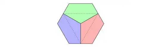

However, it turns out that at least in the $n=2$ case we can be more precise than "strictly smaller diameter"; if the original set has diameter 1, we can ensure that each piece has diameter at most $\frac{\sqrt{3}}{2}\approx 0.866$, a bound attained by the circle of diameter $1$. To see that this holds, we note that the regular hexagon of width $1$ is a solution to Lebesgue's universal covering problem, and can be split into three sets of diameter $\frac{\sqrt{3}}2$ as well: regular hexagon split into three congruent pieces I am interested in putting bounds on such dissections with more than $3$ pieces: what is the minimum diameter one can ensure when cutting a planar set of unit diameter into $k$ pieces?

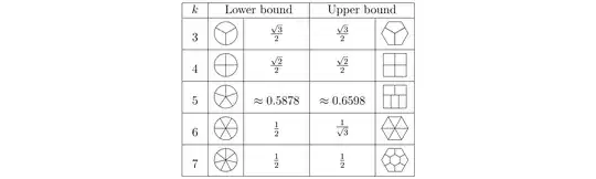

Using the same approach as above (finding specific sets with a lower bound, and dissecting a universal cover for sets of diameter 1), I have some bounds for higher $k$ as well, though only for $k=3,4,7$ are they exact:
(Extending this table beyond $k=7$ would be difficult, as working out optimal dissections for the circle would become much more complicated.)

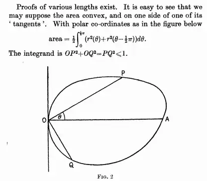

But Lenz’ bound suggest that we don’t need to use an universal covering set, because at p.11 of [Lit] it is shown that “an area of (greatest) diameter not greater than $1$ is at most $\tfrac{\pi}4$”.
This observation should point to an asymptotically tight upper bound.

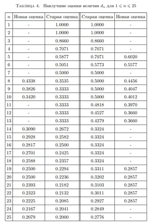

Here V. P. Filimonov, Covering planar sets, Mat. Sb., 2010, Volume 201, Number 8, 127–160 some more results about this problem, but the article is in Russian. Here link this article on English, But I don't know how to access it.
In any case, you can see pictures of the partitions of the universal covering set to prove the upper bounds of $d_n$(in his article $d_n$ is $\delta_2(n)$). On the last page, you can see the improved results at that time. The first and last columns show improved scores from the bottom and top, respectively
