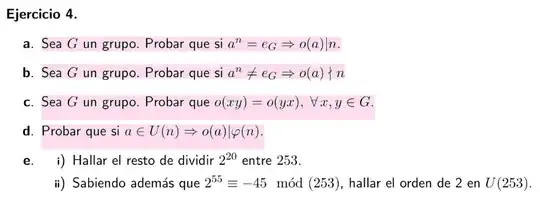

I'm currently doing exercises focused on applying concepts of group theory, Lagrange theorem, orders, homeomorphism. I'm stuck on part e of exercise 4. I guess I'm supposed to use the mentioned concepts to solve this but I can't see how. Besides, since it's the last part of a bigger exercise I think the previous parts have some to do here.
e. i) Find remainder of $2^{20} \div 253$
e. ii) Knowing that $2^{55} \equiv -45$ $(mod$ $253)$, find order of $2$ in $U(253)$
Just a clarification, we use $U(n)$ for the multiplicative group of integers modulo n

We work in the ring $\Bbb Z/253$. (So equalities are in this ring, we work modulo $253$.)
(i) $2^{20}=(2^{10})^2=1024^2=(1012+12)^2=(0+12)^2=144$.
(ii) $U(253)$ is the group of units $G=U(253)=(\Bbb Z/253)^\times$ in the ring $\Bbb Z/253$. The number of elements of $G$ is $n=\phi(253)=\phi(11\cdot 23)=\phi(11)\cdot \phi(23)=10\cdot 22=220$.
They give us the value for $2^{55}$. Then $2^{110}=(2^{55})^2=(-45)^2=2025=1$. So the order of $2$ divides $110$ by (a), but it does not divide $55$ by (b).
So $2$ is a divisor of $o(2)$. We check first the powers $110/5=22$ and $110/11=10$ of $2$. Well, $2^{10}=1024=12\ne 1$, and $2^{22}=2^{10}\cdot 2^{10}\cdot 2^2=12\cdot 12\cdot 4= 576 = 70$.
So the order of $2$ in $G=U(253)$ is $110$.
