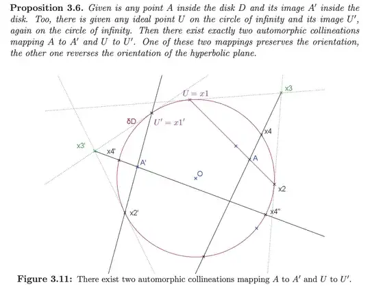

This is neither here nor there, but there is a handy practical guide Hyperbolic Geometry in Klein’s Model (by Franz Rothe) that can help with your question. In particular, the proof of Proposition 3.6 (pg 813) gives four source/target point pairs that define the projective transformation you want.
The URL (on the wayback machine) should be fairly stable, but here is the crux diagram:
Points $(x_1,x_2,x_3,x_4)$ map to $(x'_1,x'_2,x'_3,x'_4)$. Presumably you can derive a matrix from there, using math software or methods like this.
Addendum: OP asked what's meant by "counting with multiplicity, five points are mapped to other five points" in Rothe's proof. This is a shorthand for the scenario where two points on a curve converge to one and the chord they define becomes a tangent. You see it for example when the hexagon in Pascal's theorem degenerates to a polygon with less than 6 sides(e.g. page 4-5 here). In general, two tangents and three points will define 4 conics. But it will be unique if two of the points are on the tangents. A fuller discussion of the two tangents and three points case can be found in Pamfilos' A Gallery of Conics by Five Elements, Section 4.

  • Do you know what they mean by "counting with multiplicity, five points are mapped to other five points"? Which point would have multiplicity two, and what would that mean? – Sha Vuklia Oct 10 '20 at 19:20
  • A tangent counts as two points. A conic is determined by $\ell$ lines and $p$ points, where $\ell+p=5$. Because we're using $x_3$ (polar of $UA$) the mapping preserves the tangents at $x_1,x_2$. – brainjam Oct 10 '20 at 19:31
  • Amazing, thanks. – Sha Vuklia Oct 10 '20 at 20:03
  • Do you happen to have a source which proves that a tangent counts as two points? My literature is fairly limited, and I wouldn't like to dive into some higher (algebraic) geometry stuff, as I'm hoping the proof will be readable for second-year students. – Sha Vuklia Oct 10 '20 at 20:13
    See the Addendum in the answer. Hopefully it gives you the resources to cobble together an explanation/proof suitable for your students. I'm curious: is this for a course in projective geometry, or something else? – brainjam Oct 10 '20 at 21:08
