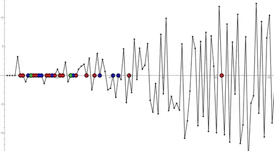

General near examples
I've searched for smallest "error" $e(n)$ such that "some elements plus the error" are a sum of the "other elements" from the "best" 5-subset of A045575 among "nontrivial" 5-subsets whose largest element is the $n$th nonzero term of A045575.
If $e(n)=0$ (and $n\ge 5$) then we have general examples(s) and $(n,0)$ is colored blue (or green if corresponding example is also "Genus-$1$"). If $e(n)=\pm 1$ we have a "near example" (colored red). Else, we have a black point $(n,\log e(n))$. For $n$ up to $100$, we have the log plot of errors:
Notice that for $n\gt 43$, we have no general examples, and for $n\gt 25$ we have no "Genus-$1$" examples (the examples I'm asking about in this question), so far.
It would seem that new examples are very large and rare or do not exist. However, notice the far right "near example" (red point) at $n=83$, which gives us hope
$$ (2^8-8^2) + (2^{16}-16^2) + (4^{16}-16^4) + (2^{32}-32^2) = (2^{33}-33^2) \color{red}{+1} $$
that maybe a large example could exist.
Do there exist any larger general examples, Genus-1 examples or near examples?
