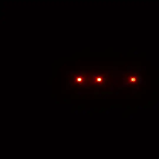

To investigate the matter, I quickly wrote up a program to track which points on the complex plane were "hit" by an iteration (represented by luminosity), starting at an initially random value. For each of my tests, I simulated $10^7$ different starting values for $z_0$. and iterated them up to $10^3$ times. Here are the results.
scale = 40 (right most-pixel is has real-value of 40)
scale=10
Not much to see here, other than $4$ attractors (seemingly on or near the real line?) being visible.
scale = 4
scale=100
Here, we start to see some structure emerge. Interestingly, the right-most concentration (which I assume is an 'attractor'), can be seen to have a ring-like structure. Just eye-balling, it seems these points are at real value $\approx 0, 1, 2.5$.

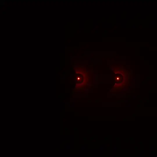

scale = 2
scale=200
The final image shows that there seems to be at least one or more 'ring' of luminosity around each attractor. I'm assuming that the 'incompleteness' (for lack of a better term), of each 'ring' is because I've only chosen initial points from the rendered region. I imagine that taking a larger subset for initial points would close the gap.
