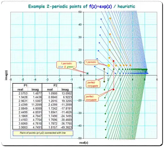

Here is a picture which included a couple more points which I found by extrapolating linear trends in subsets of the found ones. See my initial answer here
Question 1:
So my first question is now for ideas,
- 1) how could I improve the search-routine? (Perhaps avoiding that manual screening at all)
The extrapolation-idea is very useful and allows to find infinitely many more $2$-periodic points completely automatically, but it still needs an initial manual screening to get at least $3$ points as germ for the extrapolation.

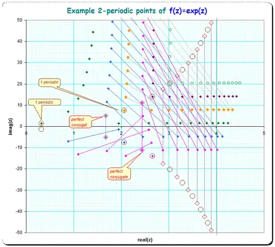

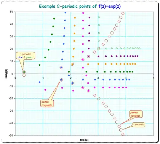

Using $Find([k_1,k_2])$ for $k_1=-3..3$ and $k_2=0..12$ I get the following chart of $1$- and $2$-periodic points (they are $1$-periodic when $k_1=k_2$) where the first parameter $k_1$ controls the color:
To see the $2$-periodicities, below is the same picture whith the pairs of periodic points connected by straight lines:
It is worth to note, that $2$-periodic points of the form $\text{Find}([k,-k])$ give pairs of complex conjugate numbers (big red diamonds), while $\text{Find}([k,k]) (=\text{Find}([k]))$ give $1$-periodic points (big brown circles). Note moreover that the $1$-periodic and the conjugate $2$-periodic points lay asymptotically on an (exponential) curve which can be seen, when the scale of the imaginary axis is taken as logarithmic (or even better transformed to $\sinh^{-1}()$ to see also the numbers with negative imaginary component ).

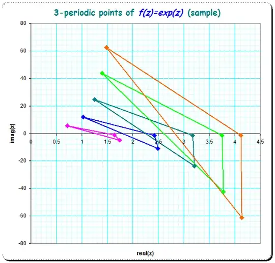

If we extend the $\text{Find}([...])$ function to $3,4,5,...n$ entries $\in \mathbb Z$ in the vector-argument we find easily any $n$-periodic point which we like. $\text{Find}([0,0,1])$,$\text{Find}([0,0,-1])$,$\text{Find}([0,0,2])$,...$\text{Find}([0,1,1])$ ...
Finally $\text{Find}([k_1,k_2,k_3])$ with $k_1,k_2,k_3 \in \mathbb Z$ give all $3$-periodic points, and in case $k_1=k_2=k_3$ the $1$-periodic fixed points and in case $k_1=k_2=k_3=0$ the primary fixed point of the $\log()$-function. Unfortunately, as Y. Galidakis pointed out in his answer, the Newton-iteration for higher iterates of the $\exp()$ gets more&more involved; numerical checks up to $n=63$ and $20$ iterations in the $\text{Find}([...])$-function however looked very promising but are still under consideration.

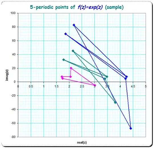

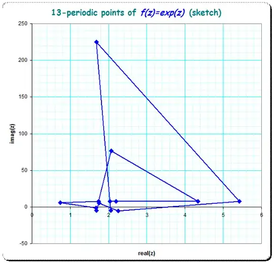

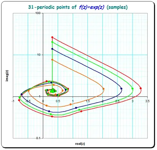

See here some picture for examples for $n=3$,$n=5$,$n=11$,$n=31$ - periodic points.
  • $3$-periodic examples
picture3 Here the coloring is chosen to make the exemplars of one shape-family better discernible where one shape-family is meant as having chosen $k_1,k_2$ constant and only $k_3$ varying.
  • $5$-periodic examples
  • $13$-periodic examples
I have shown only one exemplar because the overlay of more exemplars of the shape-family makes the picture too chaotic
  • $31$ - periodic example
Here I show 4 exemplars of a very special shape-family by keeping all but one of the vectorial arguments to zero: $$\text{Find}([0,0,...,0,k_{31}])$$ which produces the natural iteration-map for the $\log()$ for $30$ steps and then in one step adds $k_{31} \cdot C$ .
Of course, this typical shape-family exists analoguously for all $n$-periodic points.

31
 period:31    range for entries of K is -50 to +50
 [18, 41, 5, 3, -43, -44, 35, 7, -2, 46, 32, -39, 22, 0, -49, 7, 44, 19, 17, -36, 0, 0, 0, -10, -6, 32, 12, 33, -43, 14, -43]
 4.46123659082 - 268.670811286*I
 5.59362472174 + 111.543142519*I
 4.71566725871 + 259.131288260*I
 5.55750039366 + 32.9685268863*I
 3.50956315667 + 20.2533523759*I
 3.02311284853 - 268.777751156*I
 5.59394808482 - 278.019702686*I
 5.62789436426 + 218.360807399*I
 5.38648079756 + 45.5273258094*I
 3.82526317868 - 11.1133399676*I
 2.46413008062 + 287.787230418*I
 5.66225807926 + 202.624164033*I
 5.31174315327 - 243.501368016*I
 5.49536042974 + 136.681090990*I
 4.91845800632 + 1.53061225907*I
 1.63921352217 - 307.574382164*I
 5.72873115272 + 42.4168302595*I
 3.75658336920 + 277.896704179*I
 5.62734083557 + 120.937800074*I
 4.79635775505 + 108.338449219*I
 4.68623916110 - 224.668117822*I
 5.41484177250 - 1.54994085447*I
 1.72851827511 - 0.278785039562*I
 0.560104777428 - 0.159908482226*I
 -0.540452863018 - 63.1099522429*I
 4.14491514575 - 39.2784716315*I
 3.67621370882 + 199.596270778*I
 5.29646626740 + 76.9506038467*I
 4.34552685950 + 208.847190418*I
 5.34181926132 - 268.626976088*I
 5.59352139149 + 86.4136809929*I
