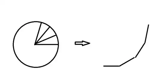

$p=1,\infty$ seem ambiguous to me, so I'm not particular how they work out. For $p=2$, Zach appears to be saying something like $\int_\gamma x|dx|\approx \gamma$ where $\gamma$ is an positive arc of the unit circle starting at $(1,0)$ and $\approx$ means homothetic. At least, if you rotate a vector repeatedly by a small positive amount then add all the resultants together in a path, you will have a circular envelope.
$l_2$ circle from the symmetry of the $l_2$ circle" />
To answer the question, you would need to provide a generalization of this aspect of $l_2$ to all values of $p$ for $1<p<2$.
