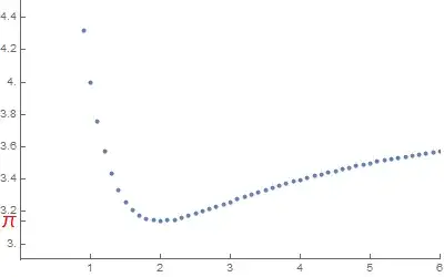

Then $\pi(n)$ is found by dividing 'circumference' by two (twice the radius). Doing so led to this graph of $\pi(n)$ against $n$.
Interestingly $n=2$ is a minimum (both local and absolute) making our commonly thought of value of $\pi$ special.

Math Question: Assuming the math above is ok, is there a reason for (2,π) (2,π) to be a minimum?
The $p=2$ is the only p-norm that has the $SO(3)$ Lie Group structure. In other words, it is rotation invariant. Try it, you can rotate the coordinate system without changing the length. You can't do that with the Taxicab metric, the length you get will change.
The deep answer to your question is that only $p=2$ has a continuous symmetry, rotation. All the other p-norms have a either a finite number of symmetries or symmetries. Here's the thing, a p-unit circle is something like every possible vector that can generated from the group glued together. Imagine starting with a small vector then copying and rotating it just a bit, attaching it to the original vector, then repeating with the copy. Eventually, you'll generate the circle. You generate any of the p-norm circles using a similar process using their symmetry, albeit a bit more opaque. So why is $p=2$ special? The circle is made with the shortest vectors, and only the shortest vectors available to construct it. Why? Because they're all the same length! This isn't true unless you're rotationally invariant and guess what? Only $p=2$ is!!
