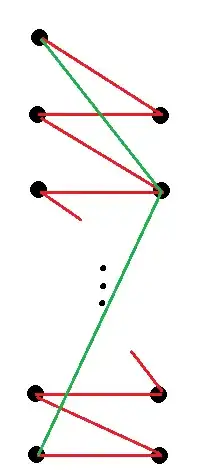

This picture shows that you can create a bipartite Eulerian Graph for any odd number ( $\ge 7$) of vertices:
bibartite Eulerian graph with an odd number of vertices
It doesn't matter that the regular red pattern ends on the same side as it started, you can just add 2 more (green) edges to get the Euler cycle.

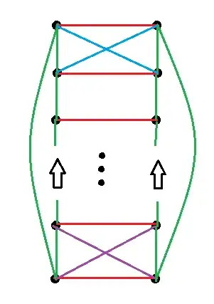

Let's look at the case of even $n$:
K_n with perfect matching removed
The construction above means all edges between points are in the graph, except the red "ladder rungs". I've just select 2 cycles in green on each side of the ladder and a few more edges (blue and purple).
You get one Hamiltonian if you start anywhere on the left side of the ladder, go up until you reach the first blue edge, then cross over to the right side with that blue edge, then take the downward "outer" green edge and go up again on the right side until you meet the other blue edge, cross back on it to the left side, take the left "outer" green edge to the bottom and go up until you get to your initial starting point.
You get a different Hamiltonian if you do this procedure again, but use the purple edges to cross from left to right and back.
It should be clear that there are so many way you can select the left and right points and choose how they are ordered in the green cycles that "just 2" Hamiltonian cycles is already a vast understatement for the minimum $n$ of 10.
