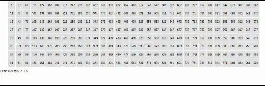

I update the answer with some images that allow to visualize the difference between the traditional sieve and three optimizations with wheel
wheel with base prime $2$
and wheel with base primes $2$ and $3$
In this case it can be seen that in row $\quad 1\pmod 6 \quad$ the starting value to eliminate multiples is $\quad p\cdot p \quad$ instead in row $\quad 5\pmod 6 \quad$ the starting value is $\quad p\cdot (p+2) \quad$ if $\quad p\equiv 5\pmod 6 \quad$ or $\quad p\cdot (p-2)\quad$ if $\quad p\equiv 1\pmod 6$
Finally, this is the case wheel with base primes $2$ , $3$ and $5$
As it is possible to visualize the multiples of the prime numbers of the base are not considered in this way it uses less memory and an increase in speed.
