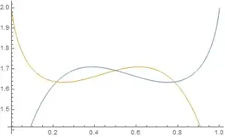

The function $\frac{f'(x)}{f(1-x)} = \frac{1-x-x \ln x}{(x(1-x))^x}$ lies between $1$ and $2$, and has one local maximum and one local minimum. A sketch is as follows (blue curve).
$\frac{f'(x)}{f(1-x)}=\frac{f'(1-x)}{f(x)}$ at three places; the intersections are simple. Since $x=0$ is a local maximum, it follows that the only other local maximum is at $x=1/2$. Then $f(1/2)=1$.

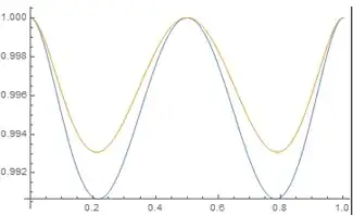

Corollary $F(x):=-\ln(f(x)^2+f(1-x)^2)$ also has three local minima at $x=0,\frac{1}{2},1$.
A Taylor expansion at each point gives $F(0+h)=h^2+o(h)$, $F(1/2+h)=ch^2+o(h)$ where $c=4 - 4\ln2 - 2\ln^22\approx0.267$, $F(1-h)=h^2+o(h)$.
Hence fitting a polynomial with double roots at $x=0,\frac{1}{2},1$, namely $\alpha g(x)$, a necessary condition for $\alpha g(x)\le F(x)$ is $\alpha\le \min(4,16c)=4$. A sketch of $F(x)$ shows that the worst cases are at these points; and that $\alpha\le3$ is sufficient for $F(x)\ge3g(x)$. No simple proof for this, just a splitting into ranges $[0,1/8]$, $[1/8,3/8]$, $[3/8,1/2]$, and use Taylor series on each.
