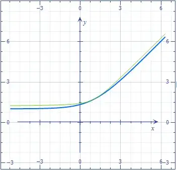

$$\begin{cases}x\le a\to\ln(e+e^a),\\a\le x\le b\to\dfrac{\ln(e+e^b)-\ln(e+e^a)}{b-a}(x-a)+\ln(e+e^a),\\x\ge b\to x-b+\ln(e+e^b)\end{cases}$$
You choose $a<b$ freely. This is piecewise linear.
Alternatively,
$$\frac{x+\sqrt{x^2-2x+2}}2+\ln(2).$$
This is reasonably tight, with asymptotes parallel to those of the original function. And more generally,
$$\frac{x+\sqrt{(x-a)^2+1}-a-1}2+\ln(e+e^a).$$
