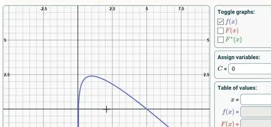

This is the graph of your $ln\lambda(\mathbf{x})$ where I just set $T=-\sum_{i}ln X_i$ and fixed some parameters
As you can see, say
$ln\lambda(\mathbf{x})<c$ is equivalent to
$T<c_1$ and $T>c_2$
As suggested, I think it is better to set $T=-\sum_{i}ln X_i$
Now it is easy to check that $Y=-lnX\sim Exp(\theta)$ so $T\sim Gamma(n;\theta)$.
Thus under null hypothesis $2\theta_0 T\sim \chi_{(2n)}^2$
and you can now solve the problem with the tables
