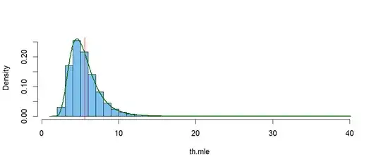

Here is a simulation for $n = 10$ and $\theta = 5.$
th = 5;  n = 10
th.mle = -n/replicate(10^6, sum(log(rbeta(n, th, 1))))
mean(th.mle)
## 5.555069   # aprx expectation of th.mle > th = 5.
median(th.mle)
## 5.172145
The histogram below shows the simulated distribution of $\hat \theta.$ The vertical red line is at the mean of that distribution, and the green curve is its kernel density estimator (KDE). According to the KDE, its mode is near $4.62.$
den.inf = density(th.mle)
den.inf$x[den.inf$y==max(den.inf$y)]
## 4.624876
hist(th.mle, br=50, prob=T, col="skyblue2", main="")
abline(v = mean(th.mle), col="red")
lines(density(th.mle), lwd=2, col="darkgreen")
