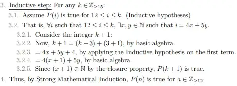

Induction Step(included after a comment by fleabloods):
Screenshot of inductive step

  • You didn't include what the induction step actually was..... – fleablood May 30 '20 at 06:48
  • @fleablood Is the induction step a must for the question(since I wanted to ask about the base cases)? – Leon May 30 '20 at 06:51
  • Well, the authors explanation was about why they needed to to the extra base cases because the induction step wouldn't work. We need to see what the induction step was to see why it wouldn't work. – fleablood May 30 '20 at 07:26
  • See... so not the step from 3.2.2. to 3.2.3. The author is assume that because it is true for $12\le i \le k$ then it is true for $k-3$. ... But that assumes $12 \le k-3$. Since $12,13,14 - 3 < 12$ we can't use the induction step yet. We can start using the induction step at $n=15$. It MIGHT have be easier to say: Let our base case be $n=15$. The let $n=12,13,14$ be "sub-base cases". Then if we assume it is true for all cases $k-3 \le i\le k$ we can show it is true for $k+1$. – fleablood May 30 '20 at 15:05
  • I think Omnomnomnom's answer provides a better approach. To paraphrase in my fleablood way: Look instead of doing induction step $P(n)\to P(n+1)$ we do induction step $P(n)\to P(n+4)$. Thus for a base case of $n=i$ we will have proven it for all $n = 4m+i$. But as that isn't all the integers we will have to do it for a base case $n=j$ to get prove it for all $n$ of the form $n=4m+j$. As there are four forms a number can take $4m+0;4m+1;4m+2;4m+3$ we need $4$ base cases. $2$ is our base case for $4m+0$. $13$ is for $4m+1$. $14$ is for $4m+2$ and $15$ for $4m+3$. that covers everything. – fleablood May 30 '20 at 15:13

You didn't include what the induction step was!
We can't evaluate their argument if we don't know what the induction step was.
But from their commentary I suspect the induction step is something like:
If it is true for $n$ and for all values between $12$ and $n$ then it should be true for $n-3$ (assuming $n-3$ is between $12$ and $n$); then $n-3 = 4x + 5y$ for some $x,y$. So $n+1 = 4(x+1) + 5$.
But what's wrong with that?
Let's try it on $12$. Let's try to go from $12$ to $13$. It is true for $12$ and for all values between $12$ and $12$. So it should be true for $12-3=9$ (assuming $12-3=9$ is between $12$ and $12$) and ..... ....!!!!skreech!!!!!.....
NO! $9$ is not between $12$ and $12$ so we can't use the induction step.
Okay we'll can figure out a special case for $13$. So we now have that is it true for all $13$ and all numbers between $12$ and $13$.
Let's try to use the induction step to go from $13$ to $14$. It is true for $13$ and for all values between $12$ and $13$. So it ought to be true for $13-3=10$ so long as $10$ is between.... Oh G#@%!
So we do a special case for $14$.
But, lord, how long can this go on?! How many special cases will we have to do before we can do the induction step and never worry about special cases?
Well, we can do our induction step if we can assume that $n-3$ is between $12$ and $n$. But for $n-3$ to be between $12$ and $n$ we must have $n$ at least $15$. So we can't use our induction step untill we have gotten to $15$
So we need special base cases for $12,13,14$ and $15$.
