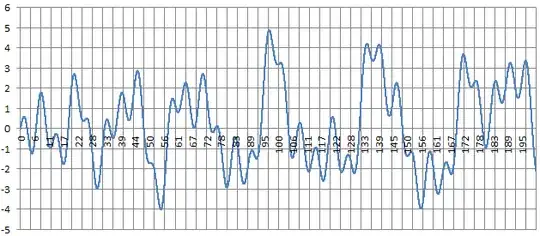

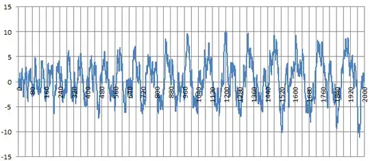

Below are two plots of $f(x)$, the first one for $0\leq x\leq 200$, the second one for $0\leq x\leq 2000$.

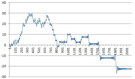

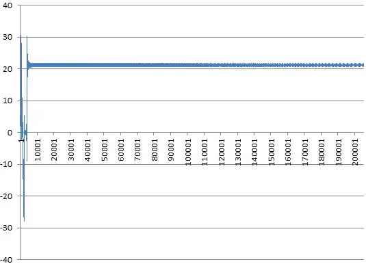

As an illustration, below is the computation of $f(x)$ for $x = 52,000,001$. The first chart shows $f(x)$ based on the first $n=2000$ terms in the series. Here the X-axis represents $n$, and the Y-axis represents $f(x)$ for the particular value of $x$ in question, when using a growing number of terms. In the second chart, $n$ goes to $200,000$. Stability is reached after adding about $4,100$ terms, and oscillations are slowly dampening then.

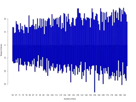

The corresponding number of elements in the sum above for values of $x$ ranges from 63 to 197.
A plot below shows the distribution of function values by total number of elements in the sum
Distribution of Function Values by Approximation Pairs
We see that we have at least one root for $x$ values with the same number of $2K^{\prime}$ pairs.

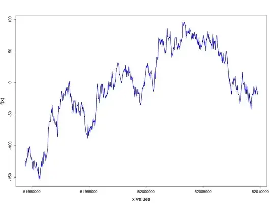

We are going to show an equally spaced sequence of $x$, where $f^{\prime}(x)$ changes signs 59% of the time between two consecutive values. Let's consider interval $[51,989,419; 52,009,776]$ and plot the function there for 1000 uniformly selected points. We used 5099 pairs(see the definion in my previous answer) to approximate function values.
Function Plot

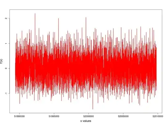

Now let's turn to the sequence with oscillating about zero derivatives. The first value is $x_{0} = 51,989,402$, and it approximately equals $\pi/2\mod{2\pi}$. Then $x_{i} = x_{0} + 2\pi*i, i = 0, 1, ....$ is defined on the interval above, and it has 3247 values. Here is a plot of derivative values for this sequence
Distribution of derivatives
The function oscillates about zero, and for 1920 points it changes sign from current value to the next one suggesting local extrema somewhere in between.
