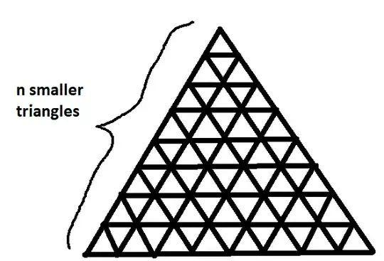

Given $n$, consider the following figure: general figure

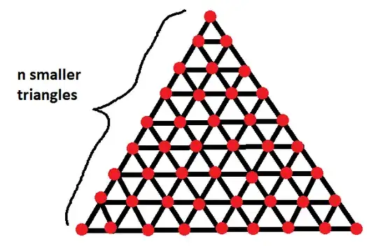

which is formed by placing $n$ equally spaced vertices along the edges of an equilateral triangle and connecting them. The intersection of the lines created will be called the vertices of the figure; the ones in red below:
vertices

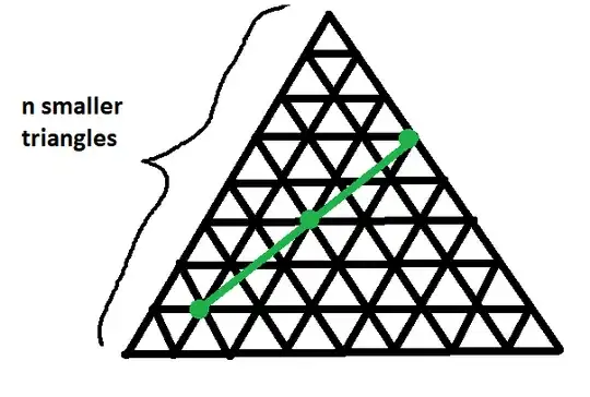

The problem is that we might have some colinear points as below, which I do not know how to deal with (in green):

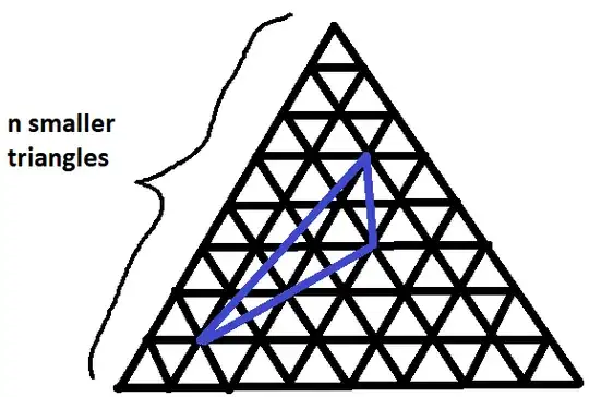

Remark: in this question, there is an answer when only considering the "upwards" or "downwards-pointing" subtriangles, but we allow for subtriangles such as the one below (in blue):

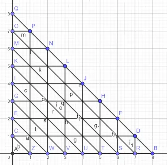

I find it easier to think about if we do an affine transformation that makes the left edge of the triangle vertical. Affine transformations keep the fact that three points are colinear, so we can do that. Your figure then looks like the one below. The nice thing is that the points are on lattice points, with integer coordinates. You can then look at the number of selections of three points that have a common offset from the first to the second and the second to the third.
