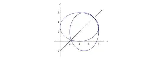

Note that the reflection of the ellipse $\frac{(x-4)^2}{16}+\frac{(y-3)^2}{9}=1$ with respect to the line $x-y-2=0$, which has a tangent angle of 45-degrees, is the ellipse that is centered at $(5,2)$, the reflection point of $(4,3)$, and is rotated at 90-degrees, as shown in the graph
So, the equation of the reflection ellipse is,
$$\frac{(x-5)^2}{9}+\frac{(y-2)^2}{16}=1$$
Then, compare with the given equation $16x^2+9y^2+k_1x-36y+k_2=0$ to obtain $k_1=-160$ and $k_2=292$.
Quanto
  • 120,125
  • Is there a reason that the ellipse got rotated 90 degees? It’s obvious from the graph, but looks hard to be done analytically – Aditya Mar 22 '20 at 04:27
    @Aditya - Because the reflection line is at the 45-degrees with the major axis of the given ellipse, it is then at the 45-degrees with the major axis of the reflection ellipse. Thus, the two major axes are at 90 degrees. – Quanto Mar 22 '20 at 05:03
