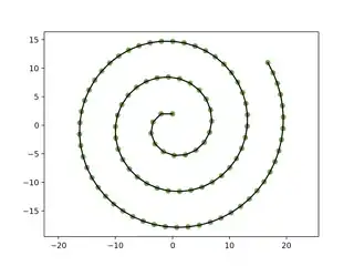

Is there an equivalent notion of winding number for non-closed curves? e.g. one that could define some notion of winding number for the curve below?
sample curve
For example, I could draw a line segment starting at the origin $(0,0)$ that extends through the curve's starting point $(0,2)$ continuing upwards. Every time the curve crosses the line counter-clockwise: +1, clockwise: -1.
Is there is a different name for this that isn't winding number? Existing formalization?

    The problem is that we want our winding number to be stable under homotopies (deformations) of the curve, but since a non-closed curve is contractible, there is no chance to find something non-trivial which would be preserved by deformations. In your example, we can deform the curve in such a way that it will not intersect any fixed line. – dsw Mar 09 '20 at 23:30

  • This answer is inaccurate. You can certainly define the winding number of any curve (whether closed or open) in this way, but then the winding number depends on the choice of origin. In particular, the winding number is then an integer if and only if the starting and ending points of the curve lie on a line of the form $\theta = \text{constant}$. All closed curves satisfy this under any choice of origin, and so have integer winding number; but for any open curve, it is trivial to choose such an origin, too. – Jivan Pal Mar 10 '20 at 00:05
  • @JivanPal I see your point, but my answer stands. (It cites an authority. If I'm wrong, then so is the authority.) The winding number of a curve always depends on a "choice of origin" (as you put it). It is always a winding number of a curve about a point. The nice thing about closed curves is that the winding number of a closed curve is constant on the connected components of the complement of the set of points on the curve. But it is still not a constant! It still depends on a "choice of origin". – Calum Gilhooley Mar 10 '20 at 00:17
  • The Wikipedia article only considers closed curves (see first sentence of article). You have extended the definition to open curves. Moreover, I never said that the winding number of a closed curve is constant (independent of choice of origin), but simply that if the choice of origin is such that the start and end of the curve lie on a line of the form $\theta = \text{constant}$, then the winding number is always an integer regardless of the choice of origin. – Jivan Pal Mar 10 '20 at 00:20
    @JivanPal Please read more carefully. Wikipedia is not the "authority" that I was referring to; nor was it I who extended the definition. I found the extended definition in Beardon's excellent textbook. Nor am I merely arguing from authority, or by intimidation. You can check all the relevant arguments (again, no pun intended!) for yourself. – Calum Gilhooley Mar 10 '20 at 00:25
  • @user8675309 That's great news! (I don't know how I missed it, because I'm on Dover's mailing list.) Sadly, but unsurprisingly, it's not an actual second edition, but a corrected reprint: Complex Analysis: The Argument Principle in Analysis and Topology. Anyway, it is the book I meant. It's not mentioned in the Wikipedia article, but in the MSE question and answer that I referred to: Are winding number and index of a not smooth closed curve the same?. – Calum Gilhooley Mar 10 '20 at 02:16
The commonly used definition of winding number depends on a choice of origin. This winding number is the number of rotations that a person standing at the chosen origin makes if they must look directly at a point whilst it traverses the curve from start to end. Since the imagined person stands at one spot, I shall call this the "standing winding number". For a given choice of origin, consider a polar coordinate system $(r, \theta)$ with that origin, and let $\big( r(t), \theta(t) \big)$ be a parameterisation of the curve, with $0 \leq t \leq T$. Then:
$$\text{standing winding number} := \frac{\theta(T) - \theta(0)}{2\pi}$$
The standing winding number is well-defined on all curves, whether open or closed, about any point that does not itself lie on the curve.
The standing winding number of a closed curve is always an integer, regardless of the choice of origin, but the particular integer value may vary depending on this choice. Specifically, it is constant on the connected components of the complement of the set of points on the curve. That is, imagine placing your finger on any point on the plane and moving it to any other point. If you can do so without your finger crossing over any part of the curve, then the standing winding number of the curve is the same about both of those points.
Indeed, an open curve will be seen to have integer standing winding number when the choice of origin is such that the start and end of the curve lie on a line of the form $\theta = \text{constant}$. That is, if the person standing at the origin walks directly towards the endpoint of the curve that is closest to them, continues walking in that direction, and eventually ends up at the other endpoint of the curve, then that curve has integer standing winding number about that point.
This "$\theta = \text{constant}$" criterion is precisely the criterion which must be satisfied in order for a curve to have integer standing winding number about a point, and since it is trivially satisfied for all closed curves (since the starting and ending points are the same point), this is why all closed curves have integer standing winding number.
We can devise another notion of winding number which does not depend on choice of origin. It is the number of rotations that a person walking along the curve makes if they always face their direction of motion whilst traversing the curve from end to end. For that reason, I shall call it the "walking winding number". We consider the curve in any Cartesian (square) coordinate system $(x, y)$, with a unit speed parameterisation $\mathbf{r}(t) = \big( x(t), y(t) \big)$ such that $\mathbf{r}(0)$ and $\mathbf{r}(T)$ are the endpoints. Consider the velocity vector $\dot{\mathbf{r}}(t) = \big( \dot{x}(t), \dot{y}(t) \big)$. We can define a continuous function $\alpha(t)$ that describes the direction of that vector (the direction that our imaginary person is facing) at time $t$. It is such that $\dot{\mathbf{r}}(t) = \big( \cos\alpha(t), \sin\alpha(t) \big)$, and its derivative $\frac{\mathrm{d}\alpha}{\mathrm{d}t}$ is unique, since the angle $\mathrm{d}\alpha$ by which the direction of motion changes after time $\mathrm{d}t$ does not depend on the choice of coordinate system. Thus, $\alpha(t)$ itself is unique up to a constant. Then:
$$\text{walking winding number} := \frac{1}{2\pi} \int_{t=0}^{T} { \frac{\mathrm{d}\alpha}{\mathrm{d}t} \mathrm{d}t } = \frac{\alpha(T) - \alpha(0)}{2\pi}$$
The walking winding number is unique and well-defined for any curve (whether open or closed), and does not depend on any choices such as coordinate system orientation or origin. Like the standing winding number, it is always an integer for closed curves, but an open curve may have integer winding number. For example, the open curve described in polar coordinates $(r, \theta)$ by $r = \theta$ has a walking winding number of:
