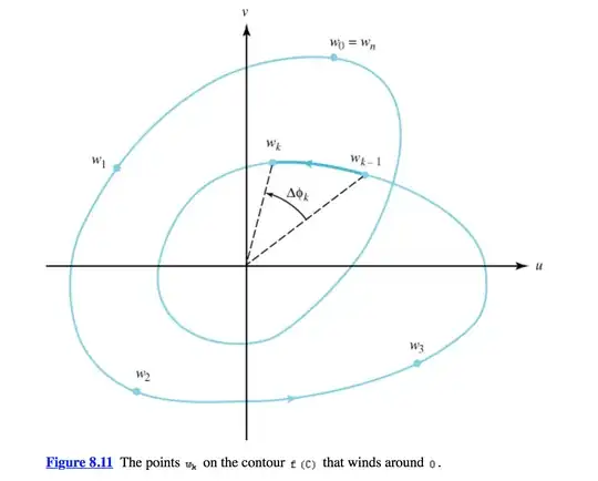

Recently, I am learning Complex Analysis. We use "Complex Analysis for Mathematics and Engineering" by John H. Mathews and Russell W. Howell as our text book. And we have the definition of Winding number in a slightly different way which is an extension of The Argument Principle . See The Argument Principle and Rouchés Theorem. The Argument Principle Z and P are the numbers of zeros and poles respectively. And then, we figure out the geometric meaning of the integral, and we find out that it is actually telling the story of the angle that f(C) turns about a point a, which is the singularity. The whole story lies in the concept of complex logarithm, where logz=ln|z|+iargz, where argz is the angle.enter image description here Therefore, if we replace f(z) by z we can get the definition of winding number of the closed curve C.
