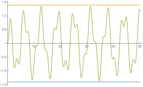

and here is a plot of $g(z)$, which seems to be periodic: enter image description here
By the result of [1], we have $$\left|\mathrm{Si}(y) - \frac{\pi}{2}\right| \le \frac{1}{y}, \ y > 0.\tag{1}$$ Thus, we have, for $z > 0$, $$\frac{\pi}{2} - \frac{1}{z} \le \mathrm{Si}(z) \le \frac{\pi}{2} + \frac{1}{z}$$ and $$\frac{\pi}{2} - \frac{1}{\mathrm{e}z} \le \mathrm{Si}(\mathrm{e}z) \le \frac{\pi}{2} + \frac{1}{\mathrm{e}z}.$$ Thus, we have, for $z > 0$, $$-1 - \frac{1}{\mathrm{e}} \le z(\mathrm{Si}(\mathrm{e}z) - \mathrm{Si}(z)) \le 1 + \frac{1}{\mathrm{e}}.$$ Also, $1 + \frac{1}{\mathrm{e}} \approx 1.367879441$. We are done.
