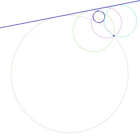

It is possible, provided that the point and at least part of the circle are on the same side of the line and the circle does not separate the point from the line. If the point and the circle are on opposite sides of the line, or if the point is inside the circle and the line wholly outside, then it is impossible (as it is with three nested circles in the original version).
Wikipedia describes this as Special case 6 of Apollonius' problem with up to 4 solutions
example of four tangents
Henry
  • 169,616
  • Thanks for the image Henry, and the link to that wikipedia article seems to be just what I was looking for. – yunone Apr 28 '11 at 01:41
