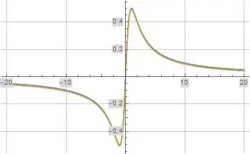

In Figures (1) to (9) below, formulas (2), (3), and (6) defined above are illustrated in orange overlaid on the reference functions defined in formulas (1) and (5) above which are illustrated in blue. Formulas (2) and (6) seem to be much more sensitive to the magnitude of $N$ than the magnitude of $f$, and consequently all plots of formulas (2) and (6) illustrated below are evaluated at $f=4$ and $N=214$. All plots of formula(3) illustrated below are evaluated at $N=401$. These evaluation limits were selected as a trade-off between the conflicting goals of minimizing evaluation time and maximizing convergence. Note $M(214)=M(401)=0$ consistent with the conditional convergence requirement stated above.

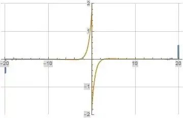

The following figure illustrates formula (2) for $f(s)$ evaluated along the line $s=i t$ using the evaluation limits $f=4$ and $N=214$.
Illustration of formula (2) for f(s) evaluated along the line s=i t
Figure (1): Illustration of formula (2) for $f(s)$ evaluated along the line $s=i t$

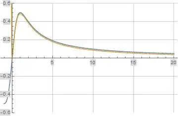

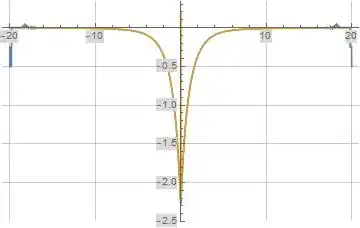

The following two figures illustrate the real and imaginary parts of formula (2) for $f(s)$ evaluated along the line $s=t+i$ using the evaluation limits $f=4$ and $N=214$.
Illustration of real part of formula (2) for f(s) evaluated along the line s=t+i
Figure (2): Illustration of real part of formula (2) for $f(s)$ evaluated along the line $s=t+i$
Illustration of imaginary part of formula (2) for f(s) evaluated along the line s=t+i
Figure (3): Illustration of imaginary part of formula (2) for $f(s)$ evaluated along the line $s=t+i$

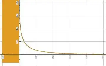

The following figure illustrates formula (3) for $f(s)$ evaluated along the line $s=i t$ using the evaluation limit $N=401$.
Illustration of formula (3) for f(s) evaluated along the line s=i t
Figure (4): Illustration of formula (3) for $f(s)$ evaluated along the line $s=i t$

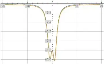

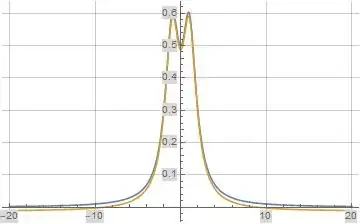

The following two figures illustrate the real and imaginary parts of formula (3) for $f(s)$ evaluated along the line $s=t-i$ using the evaluation limit $N=401$.
Illustration of real part of formula (3) for f(s) evaluated along the line s=t-i
Figure (5): Illustration of real part of formula (3) for $f(s)$ evaluated along the line $s=t-i$
Illustration of imaginary part of formula (3) for f(s) evaluated along the line s=t-i
Figure (6): Illustration of imaginary part of formula (3) for $f(s)$ evaluated along the line $s=t-i$

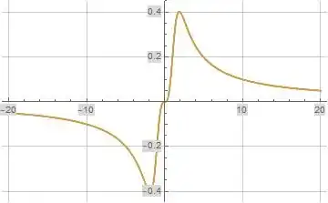

The following two figures illustrate the real and imaginary parts of formula (6) for $\mathcal{L}_t[h(i t)](z)$ evaluated along the line $z=-1+i t$ using the limits $f=4$ and $N=214$. Note formula (6) actually seems to converge better than the blue reference function defined in formula (5) as the magnitude of $t$ increases where both formulas are evaluated using Mathematica's default precision.
Illustration of real part of formula (6) evaluated along the line z=-1+i t
Figure (8): Illustration of real part of formula (6) for $\mathcal{L}_t[h(i t)](z)$ evaluated along the line $z=-1+i t$

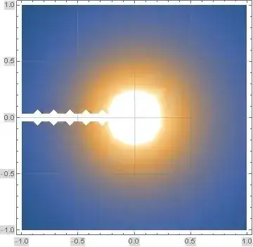

The following figure illustrates a density plot of the absolute value of the difference between formulas (6) and (5) for $\mathcal{L}_t[h(i t)](z)$ where formula (6) is evaluated at $f=4$ and $N=214$. Note formula (6) seems to converge everywhere except at $z=0$ and along the interval $(-\infty,0)$ which I believe is related to a branch point and branch cut of the $\text{Ci}(z)$ function.
Density plot of the absolute value of the difference between formulas (6) and (5)Scale for Figure (10)
Figure (10): Density plot of the absolute value of the difference between formulas (6) and (5) for $\mathcal{L}_t[h(i t)](z)$
